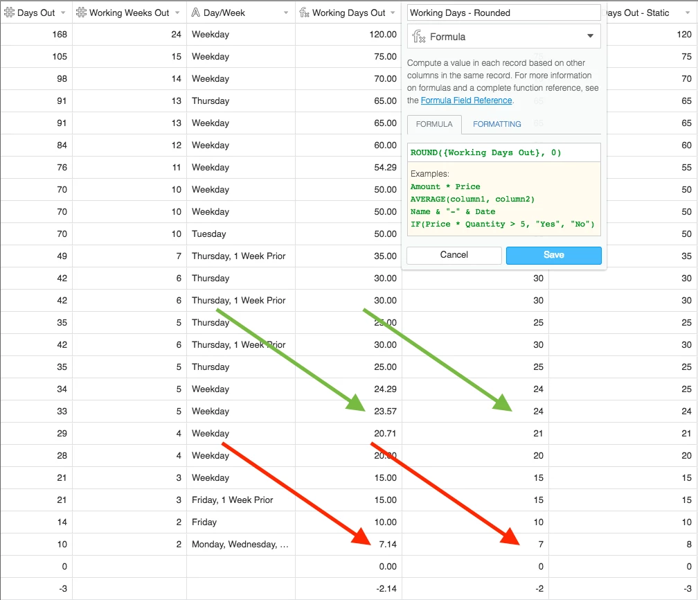

Could you provide a screenshot of this? I can’t reproduce this on my own account.
No problem; see attached. it’s rounding both up and down.
A.
[cid:FEA91212-E363-4FE0-BF27-A8D4E2F6004C]
Okay, I think I misunderstood what you were saying originally.
You are correct that ROUND doesn’t round up in all cases; it actually rounds to the nearest integer with ties broken by going to the greater integer (e.g. 25.4 will round down to the nearest integer, 25; 25.5 is exactly halfway between 25 and 26 and the tie is broken by taking the greater number, 26).
I have fixed the documentation to more accurately reflect this behavior. In the meantime, to better represent your desired rounding behavior, I suggest you follow the instructions I gave in my last post here.
