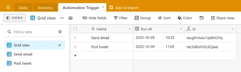

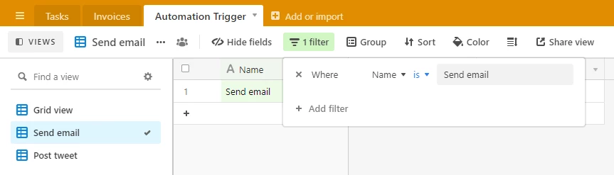

  • Dec 4, 2020 8:26 PM UTC
It’s a little bit tricky to do this in Airtable, which is why using Zapier might be the better choice if you’re already familiar with Zapier & already using it. Zapier has built-in scheduling capabilities that fires at exact times. (And I recommend Integromat for everyone who isn’t already using Zapier, since it is much more powerful than Zapier.)
