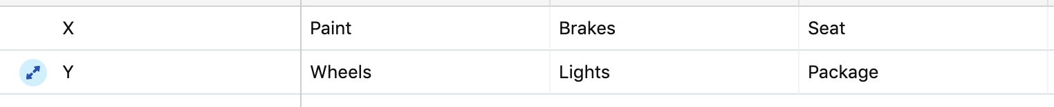

Hi @Sam_Smiley - here’s my attempt at solving this. Not sure how well it scales for a process with many steps, but see what you think.

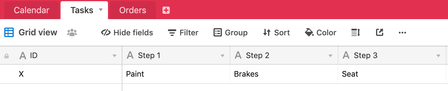

I started with a tasks table:

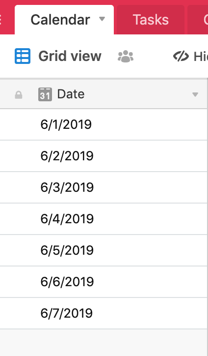

I’ve got a calendar table:

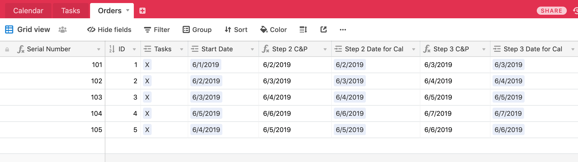

Then I’ve got an “orders” table which records instances of the process you’ve got in the 3 steps:
The serial number is just a formula on the autonumber ID field. Tasks is a link to the Tasks table and Start Date is a link to Calendar where you decide which day you want each order to begin on.
Now we come to the manual part - Step 2 C&P is the calculated date for step 2 (in this case, Start Date + 1 day). When you’re created the order copy this calculated date into the next field “Step 2 Date for Cal”. This is a linked field and when you paste you make the link. Step3 C&P and Step 3 Date for Cal is the same idea, just another day forward.

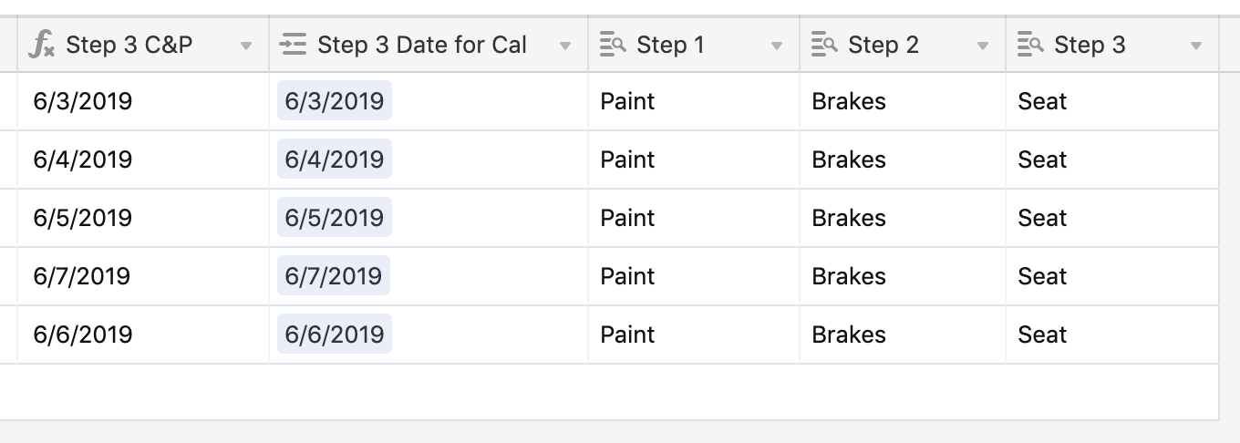

At the end of this table I’ve got a lookup to the tasks table to pull in the steps in the process:

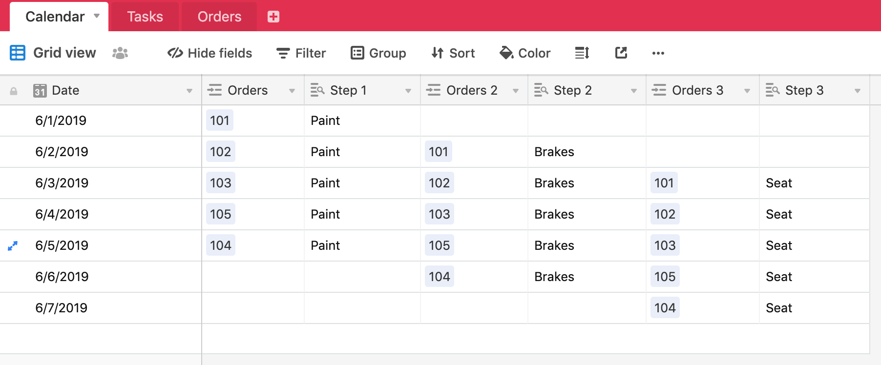

Now back in my calendar table, I’ve already got linked fields for start date, Step 2 Date for Cal and Step 3 Date for Cal (here shown as Orders, Orders 2 and Orders 3. Using these I can lookup the 3 steps in the process, linked to their dates:

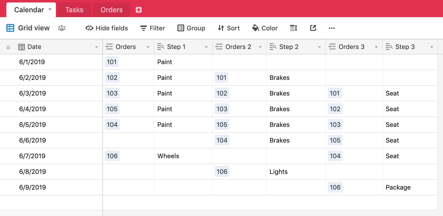

What’s nice is I can also create another (3-step) process:
And choose this to start on a given date:
The C&P element of this base is a bit tedious, although when you’re entering this data you’re just going from cell to cell horizontally, so can be quite quick. I can’t figure out a way to automate this as it seems you want a field to be both calculated (+ 1 day) and also a link in another table, which you can’t do, so getting the data correct, then pasting into the linked cell seems like an OK workaround.
Maybe this gives you some more ideas?
