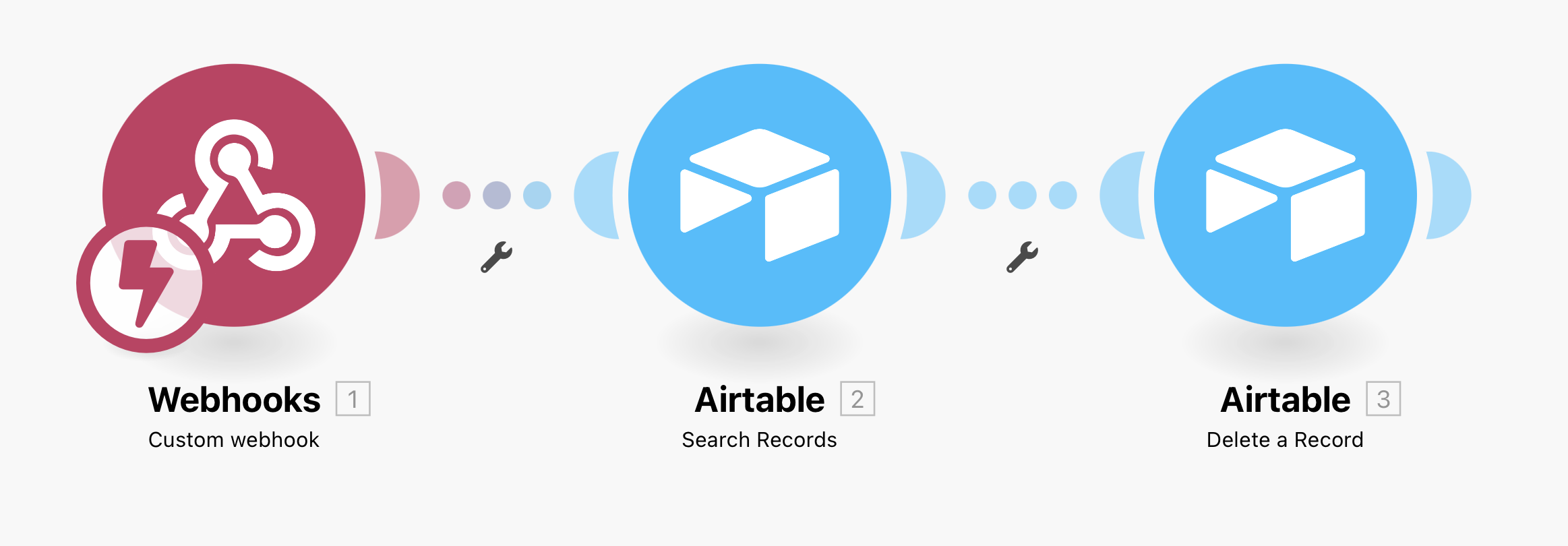

And, for those people who are reading this thread in the future who want to do this using Make (instead of JavaScript), here is a screenshot of the simple 3-step process that you would setup:
