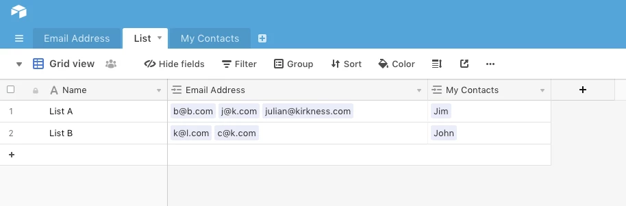

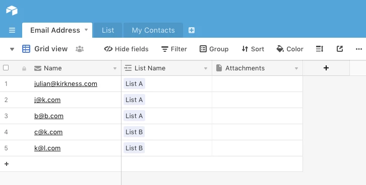

Hi @Ian_Varley
I think this would be best handled by a 3 table solution:

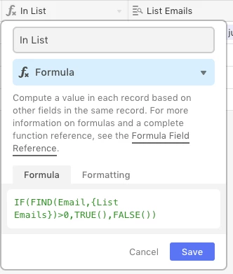

Hopefully you can follow what’s going on - it generalises the issue to allow for searching multiple lists but if you only have one that’s just fine. The last part, the formula for the In List field is:
I hope this helps (I may have misunderstood)!
