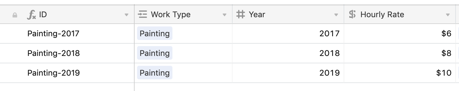

To illustrate, I’m going to assume that your job rates change every year, but it could be every month or some other arbitrary time period. In your Rates table I would have the following:
So for each job type, you’ve got a rate and a time period that it applies for.

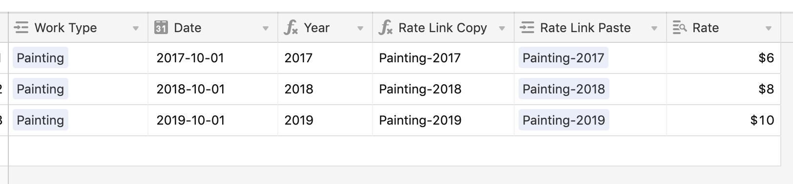

In the Completed Jobs table you might have this:
The work type and the date the job was completed are self explanatory. The Year is a formula on the date to get the year the job was completed:
DATETIME_FORMAT(Date, 'YYYY')
Rate Link Copy is a formula:
{Work Type} & '-' & Year
Rate Link Paste is a link field to the Rates table
Rate is a Lookup field using the Rate Link Paste field as the lookup source.

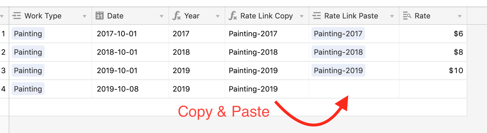

Now, when you add a new record (Work Type and Date) in the Completed jobs table, you’ll get this:
Then just copy Rate Link Copy field into the Rate Link Paste field.
You don’t have to do this record by record - select as many cells as you want and paste them in.
