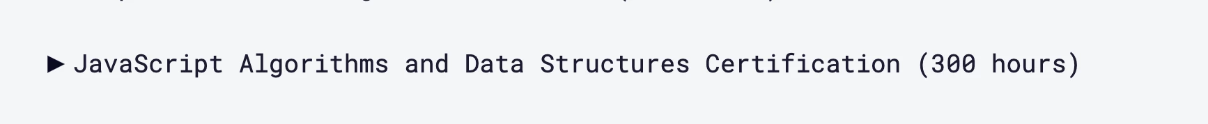

Hi @Andre_Zijlstra - great question! I know from past experience that it can be hard to get going on these things. The Airtable scripting language, as you might know, is JavaScript, so any resources on this will be useful. I would particularly recommend this free Codecademy course - Introduction to JavaScript
Freecodecamp is also a great resource - scroll down to the JS section:
Within these two resources, there’s tons of guides for basic and more complex JS examples and “how-tos”.
