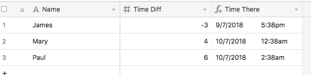

I think you could add a Time difference in hours, and then just do DATEADD(NOW() + {Time difference}, 'hours').
It works:
Even you could have a Time Zones table with the number, and link them to the Freelancers, so you have not to repeat the Time Diffs if you have so much collaborators.
