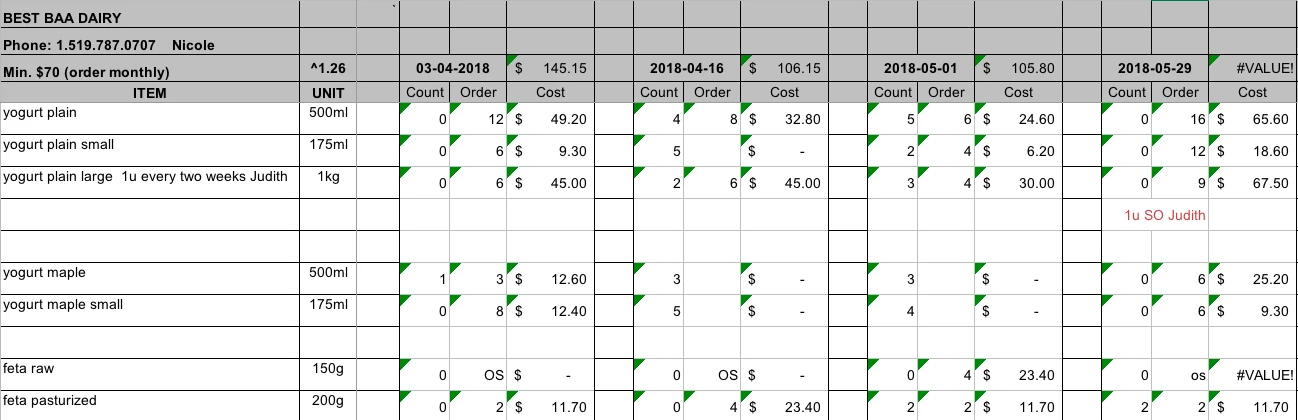

First, let me show you our current spreadsheet for one of our vendors, Best Baa Dairy. We order sheep yogurt from them every couple weeks.
When we’re about to place the order, we do a quick inventory – looking at what is on the shelf and writing down the current stock in our Count column.
Then, we look at that Count column, plus the previous orders, to get a sense of the trend. If we ordered 12 containers of yogurt last time, and now there is only 1 on the shelf, I definitely want to order more than 12.
As you can see, it’s important to view past orders and inventory trends to help me decide what number I should put in the Order column.
As time goes on, we repeat columns S, T, U to the right – and continue that forever.
At first glance, it looks like count and order should be a property of the Product record. But then I’d have hundreds of field names, like May1-count, May1-order, May29-count, May29-order… and there’s no way to automatically group those fields by date.

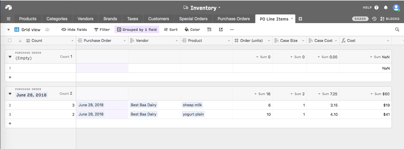

Thanks, @W_Vann_Hall. Your explanation solved my mental block and helped me see things more in the “Airtable way”.
The key for me was understanding how Linked Records, Lookup fields, and Rollup fields can be combined to achieve what I wanted.
I created a table called Purchase Orders. Each record represents a single purchase order for a particular vendor. For example, the June 28th order we placed with Best Baa Dairy:
The Cost field adds up all the relevant line items in the PO Line Items table:
I will use the Airtable API to create more a more user-friendly frontend for our staff to enter the Count and Order (units) fields for each line item.
I’m excited to deepen the data connections across this base – for example, each record in the Special Orders table will be linked to its corresponding Purchase Order. Then when we receive the shipment, we can see which Special Orders we need to set aside, and which products can go on the shelf.
(Surprisingly, we had a difficult time finding a retail POS software that could accomodate this workflow. I’m thrilled it’s going to be possible with Airtable.)
