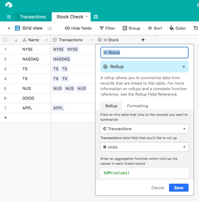

Yes, of course.
There are not to many calculations.
“Code” field is a link record to Stock Check Table.
“Total” is a formula “Units” * “Price” fields.
May be the one you need is the rollup formula in “In Stock” field which I attach below.
Any question, be my guest.
Rgds
