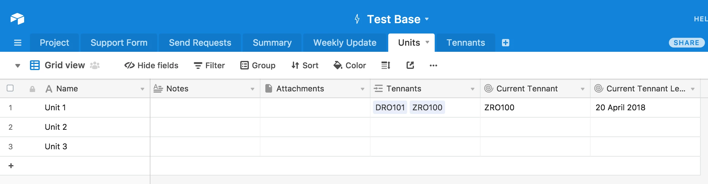

I’ve worked up an example of the first part of your problem for you - I’m assuming you have a table Units and another Tennants. If we first set up Units:

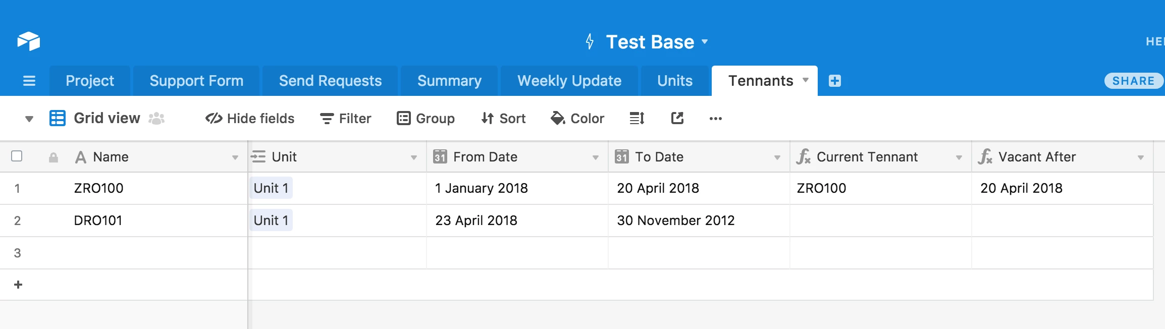

Ignore the fields for Tennants, Current Tennant and Current Tennant Leaves fields for the moment - now we set up Tennants:

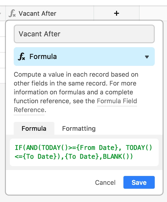

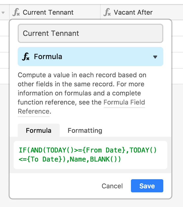

This table is pretty much as you would expect - with t link to Units (the Unit field), arrival and leaving date. The clever stuff is in the two calculated fields which use a formula to fill in the Current Tennant and Vacant From Dates if there is a tennant there:
Calculating these seems strange - but we’ll use roll up fields in the Units table to display this information:

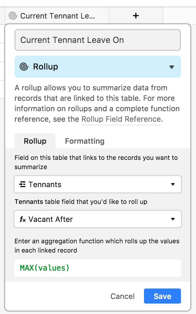

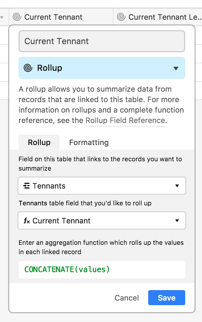

So, back on the Units table, we can now use rollups:
and
Note that with Vacant After you may want to format the date to suit.
