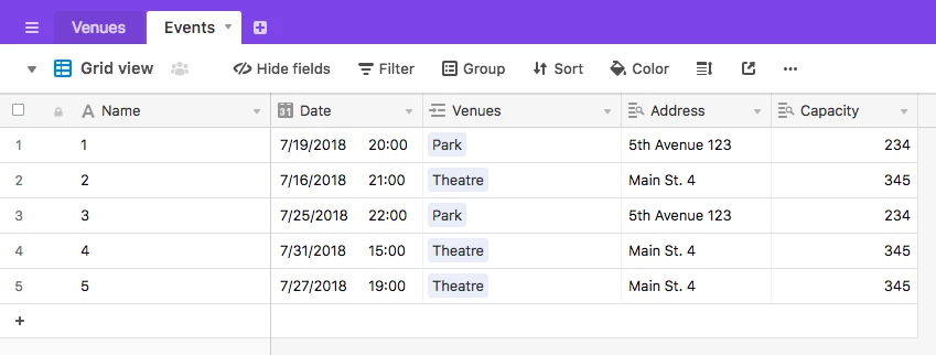

If the 2 Tables contain elements of the same type, you should use Views. If they are different but Related, you could use a Linked Record field and then Lookup fields to reference data. For instance, think of Events and Venues tables: you can have an Address field on the Venue, and show it on the Event/s (always the same address for events in the same Venue).

Continuing with your example, lets say I have venue names in the first column. Then I have columns of venue capacity, venue address, ticketing URL, and age restriction. I want to pull the data from two of these columns into another Tab/Table. In Sheets the =IMPORTRANGE function can achieve this.

You just create Lookup fields in the Events table.
