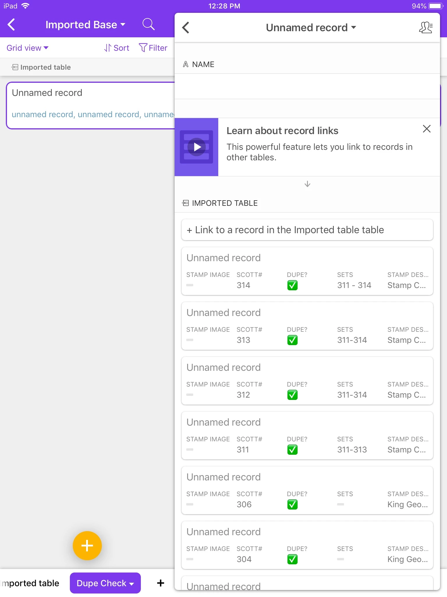

Well, to start with, here’s a version of the base that flags duplicate entries as based on the value of the {SCOTT #} field.
As do all of my de-duplication bases, it requires every record in the de-duplicated table be linked to a single record in another table. In this instance, I’ve called the new table [Dupe Check], and the linked record field I’ve given the clever mnemonic {Dupe Check}.
If you enter new records manually, as part of the data entry process you will need to select the plus sign ('+') in the {Dupe Check} field and then click on the sole record in the [Dupe Check] table, which I’ve named '✅', the Large White Check Mark emoji. I chose this name because it makes it easy to see which records are not properly linked to the [Dupe Check] table, as properly linked records appear in this field as an unbroken column of check marks.
But you don’t enter records by hand, do you? In that case it’s even easier to link new records: After adding new records to the table (either through importing or by copy-and-pasting new records), go to the row immediately above the first record added. (I’m assuming it is already correctly linked, so that it’s {Dupe Check} field has a value of '✅'.) Select that cell’s fill handle — that is, the small white square that appears in the lower right corner of the cell. While holding down the mouse button, drag the fill handle to the bottom-most row of the table. This will copy '✅' into all the linked record fields of the newly added records and cause links to be created automatically.
Once records have been linked correctly, any record whose {SCOTT #} matches that of another record will have its {Dupe ?} field set to '✅'. (I’ve also set conditional colors to mark duplicate records with a red flag to the far left.) You can either scroll through the base, looking for duplicates, or set your filter to show records where {Dupe ?} is equal to '✅'. In the base as provided, there are two duplicates. (That is, there are two instances of duplication, meaning four records are tagged as duplicate.) While some implementations of these routines provide a method by which ‘acceptable’ duplicates can be indicated, it appears there are no conditions where such duplicates would be allowed, so I’ve not included that functionality, instead assuming you will simply delete all but one of the duplicate fields.

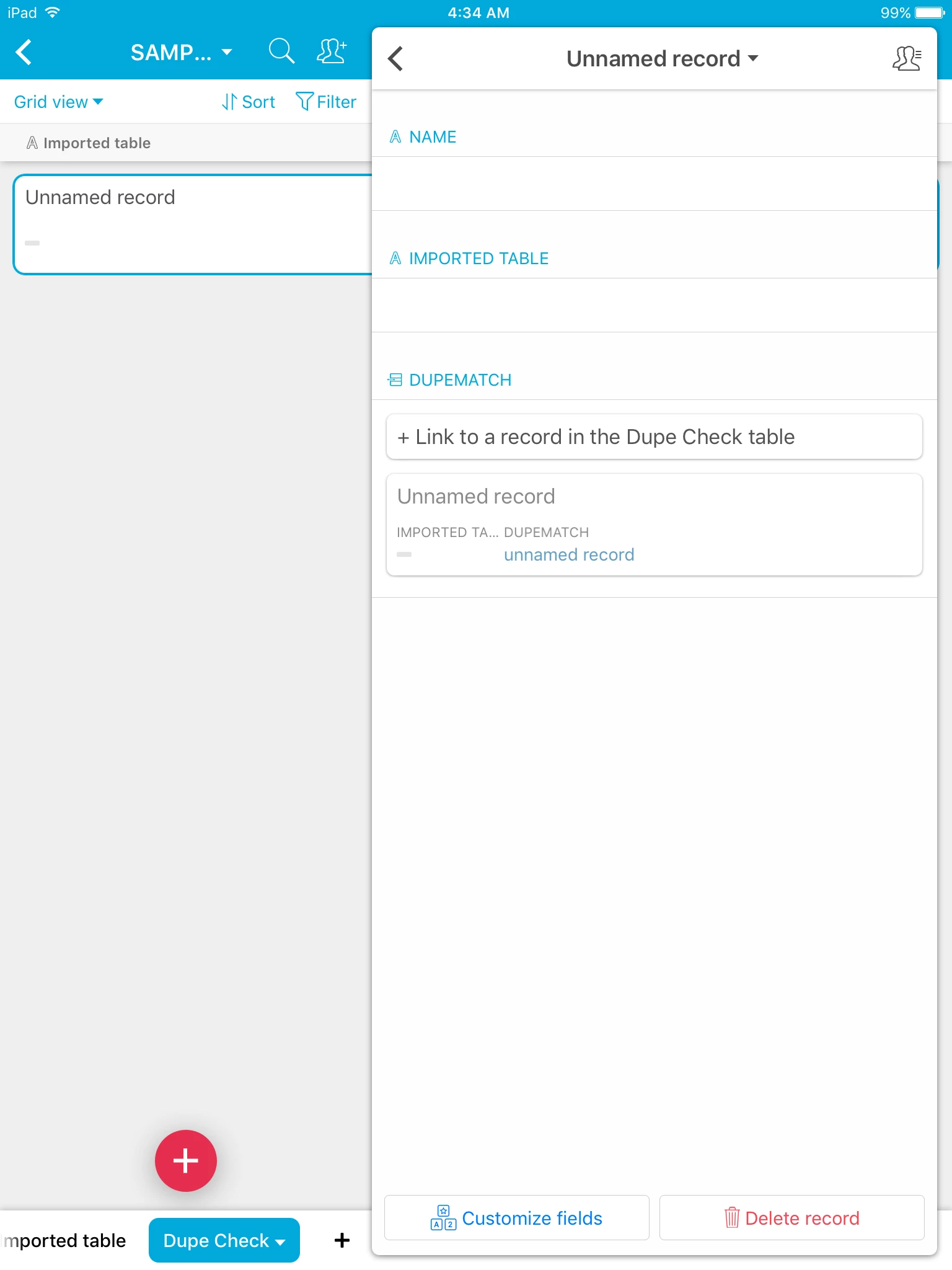

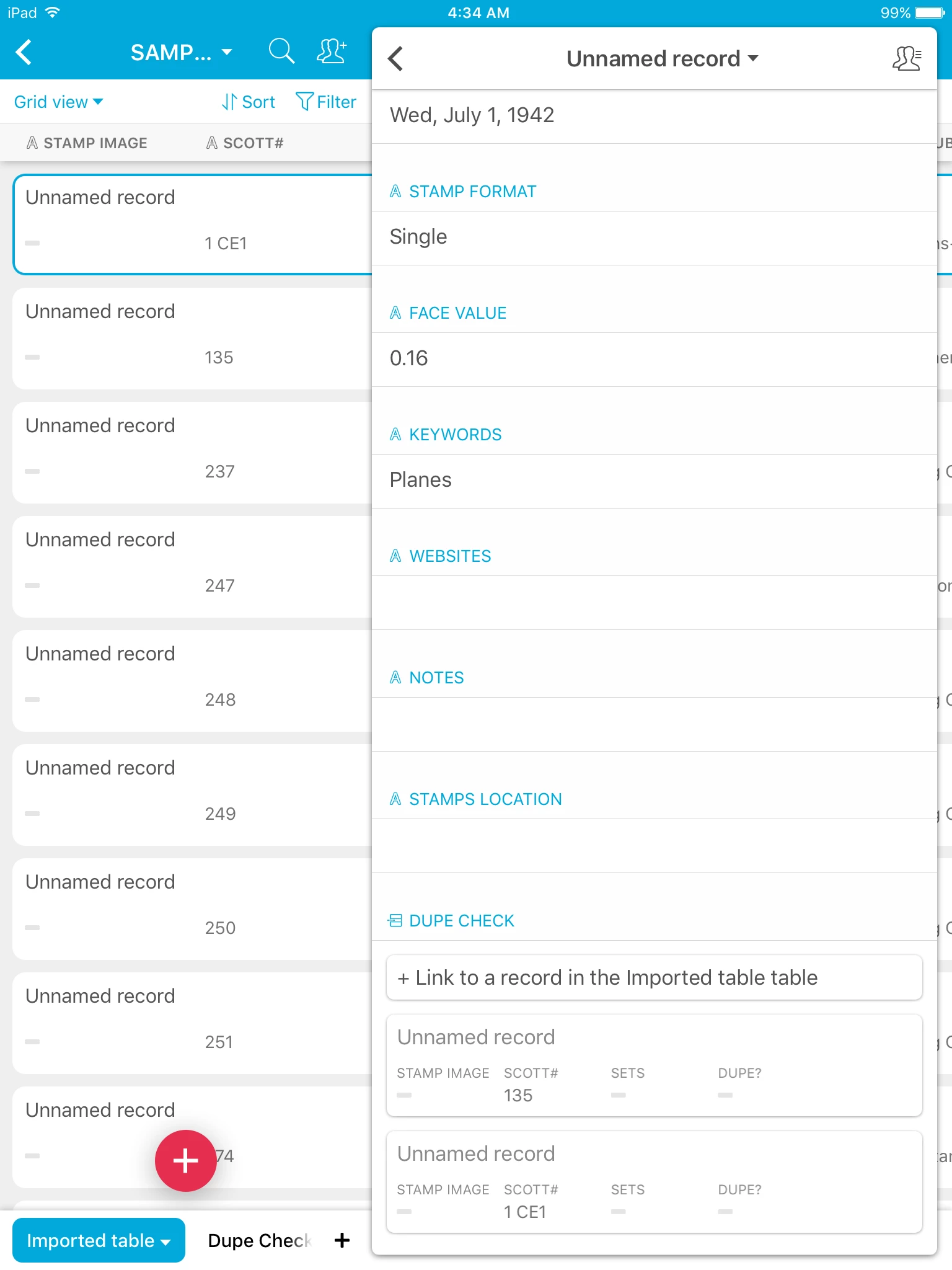

Well, I know why it’s not working — I just don’t know why it’s not working.
Actually, the step you missed was to link every row of your [Imported Table] to the single record in [Dupe Check]. You’d do this by pasting whatever the name of that single record is into the {link to Dupe Check} field in every row of [Imported Table].
That should be all it takes to set up for deduplication; unfortunately, when I made that link, every record lit up as being a dupe. The formulas are identical for my sample base and your implementation. So what’s up?

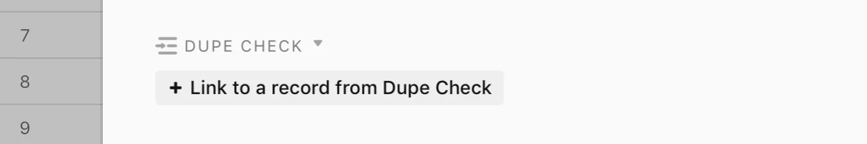

I have been trying to get the Checkmarks showing (linking) and it’s still not working. I have imported the CSV file first, I than created the field ScottFixed field and copied and pasted the the formula: SUBSTITUTE({SCOTT#},’\n’,’’) into the Formula field. I added this field from the last reply:
“OK, for the meantime, you can create a field called ScottFixed. Give it the formula
(It appears the extra characters are newlines.) Change {DupeCheck::SupeMatch} to roll up {ScottFixed} rather than {SCOTT#}. You’ll still get 100% duplications — but that’s correct, as I see you’ve entered the values twice to force duplicates.”
Then I created the second table SupeMatch. I then proceeded to link both tables, I created the Dupe? field as Rollup: SupeMatch (link), DupeMatch (Rollup) then I copied and pasted the formula: IF(FIND(’|’&{SCOTT#}&’|’,values&’’,FIND(’|’&{SCOTT#}&’|’,values&’’)+1)>0,‘ :white_check_mark: ’) into the Rollup dialogue box.
but the SupeMatch field shows, in table 1, at the last field, but with no Checkmark, nor checkmarks in Dupe? field.
I than proceeded to go to table 2, which I set the three fields up already: Name-text, Imported table-link, DupeMatch-Rollup (Imported table, ScottFixed, formula: ‘|’&ARRAYJOIN(values,’|’)&’|’ into the Rollup dialogue box.
but all I got were two vertical lines in the 3rd field, (DupeMatch) so I don’t know why it’s not working. Could it be the set-up sequence?
I also was not sure about what table to select when setting up the links i.e. Name of linked field in table 1-Importrd table, select-Imported table, Table 2-name of linked field-DupeMatch selected-DupeMatch.
You also mentioned about the length of the Scott#/ScottFixed field, could I do something to correct it?:
“Somehow, it seems your imported table has some sort of control character flanking {SCOTT#}; if I do LEN({SCOTT#}), the seeming 3-digit values have a length of 5; 5-digit a length of 7. It could be a line-feed or newline character. Not sure where it came from.”
Now, if I can get those checkmarks showing I will be on my way, since I now understand how this table works, I am also a bit new working with Airtable, eventhough I enjoy learning new things and linking and rollups are new features for me. :grinning_face_with_smiling_eyes:
PS I have since learned, after writing this initial reply, that I need to link individual records from one table to another, so do I first select the Dupe Check field, in the 1st, table, then select the option “Link to record in the Imported table” link, or do I go to the 2nd. table and select Imported table Field and select “Link to a record in the Dupe Check table”? I’m not quite sure.
I have attached screenshots, illustrating the above paragraph:
Thank you.

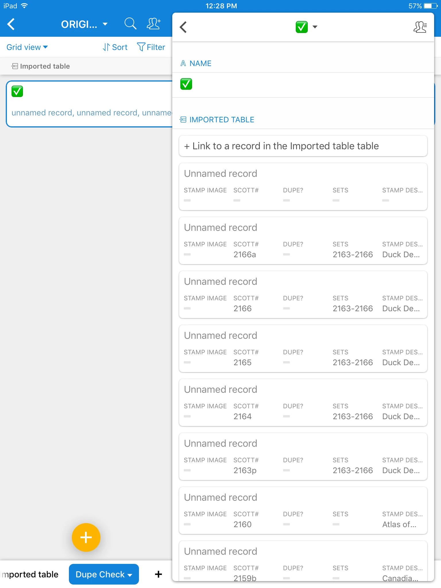

Hi
I have an update from my previous reply.
I was checking the base that was created for De-duplicating Routines and I was comparing it to the base that I created and I noticed that I did link the two bases and all the records, but for some reason the checkmark is not showing in the 1st field of the second table (Dupe Check table), but it does show for all the records in the Dupe? field in the first table.
I took screenshots of the same, but from different databases. The first screenshot is my base and the second screenshot was the original base, so I don’t know how to correct this. In my previous reply, #18, i wrote the sequence setup that I used.
Thank you.

The difference between the 2 seems to be in the {Name} field.
In the first screenshot, the record were you linked all the others have is not named, in the second screenshot it is :winking_face:
You can, I think, just copy the name of the single record from the 2nd screenshot ( :white_check_mark: ) and past it in the {Name} field of the base in the 1st screenshot.
