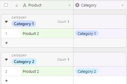

My issue is this. Without filtering, I have grouped up products by whichever category currently has them in stock. Now, I want to find out which Category does not have Product 1.
What I’ve done is to Filter by Where Product does not contain Product 1 . And my expected output is to only show Category 2 , which does not have Product 1 in it.
With Filtering
However, doing this kind of filter also returns Category 1, which has both Product 1 and 2. How can I filter it out so it will only return groups that do not have Product 1?

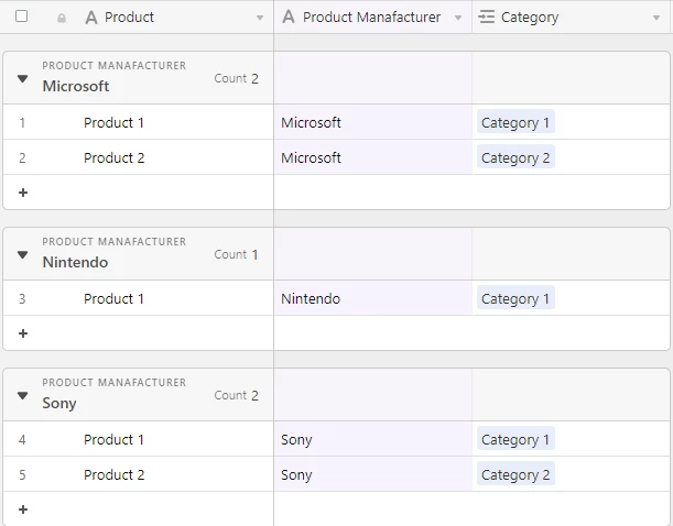

What I want to do is to reference the 2nd Column (Product Manufacturer) in the Categories table, then filter out which Manufacturers only have a Product 1 or Product 2 only, but never both at the same time. For instance if say I want to know which Manufacturers only have Product 1, it will only show me Nintendo, and not Microsoft and Sony since those have both Product 1 and 2.

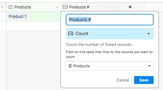

You can set a filter to “Category contains Category 1”, but you also would need to add filters to exclude the rest of categories. Maybe you could do another thing: create a Count field for the categories, and add a Filter to “Categories Count is 1”.

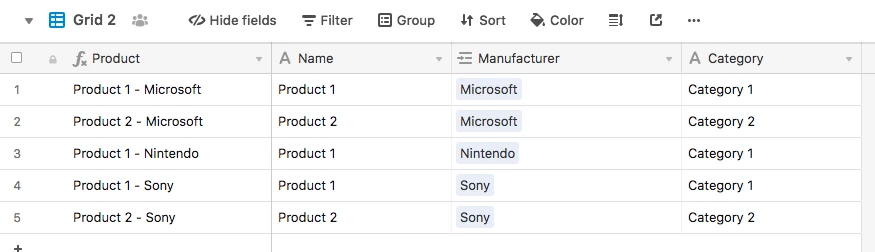

No, but you can make the primary field to be a Formula field, so you can show the information you want, adding first a new field for the Name itself.

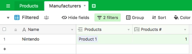

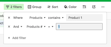

You want to filter Categories or Manufacturers? It’s the same as in Categories, you need the Manufactures in another Table. Then you could add the Counter field and create the Filters:
  • Product is Product 1
  • Counter is 1

Yes looks like that would only be the way to go about filtering, but I’ll give the count field a shot if it’s cleaner.

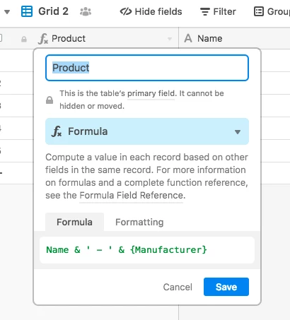

Is it possible though to have a varying primary field for each view? Or is a separate table the only solution?
I can’t wrap my head around the primary being a formula field, but if I understand it correctly, a formula field where it would reference the field I need/want displayed, and then modified for each time I want to reference another one?
I think it’s easier to show you instead of explaining it over a reply, I hope this makes sense
Demo Base - Airtable
Explore the "Demo Base" base on Airtable.
Primary Field:
