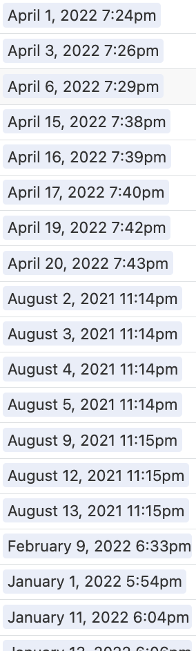

hi!
i have a field that is linked to another table, and that field is a date.
I’m trying to sort chronologically, but from what i see, it can only be sorted alphabetically.
is there a way to change the settings of the date to yyyy-mm-dd in numbers instead of mm-yyyy now so i can sort chronologically? or any way to do that?
thanks!
Best answer by kuovonne
Are you using the Batch Update app? That always does an alphabetical sort. You can change the format of the primary field in the linked table to ISO format.

ah that’s the problem, the field customization is “link to xyz table”, so i cannot edit the date format
  • Apr 20, 2022 12:16 PM UTC
  • Apr 21, 2022 3:59 AM UTC
ah i found it! thanks!
