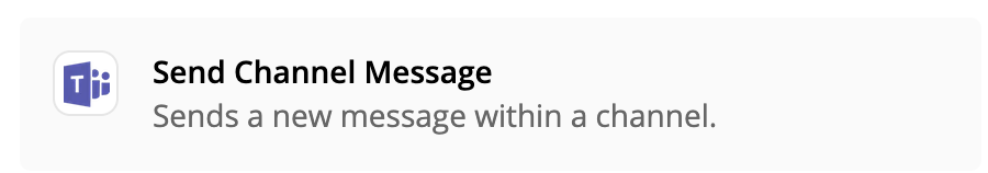

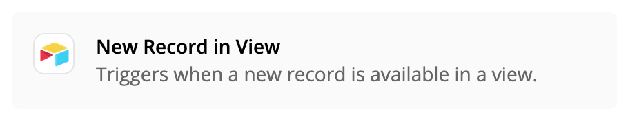

Hi @Glenn_Felty - how about using Zapier? You can then have an Airtable trigger:
and send this to Teams:
Of course, if you trigger a lot of records or they are more complex than the two step process above, you would need a Zapier subscription, which defeats your purpose, but if they are small in number, a free Zapier account might do the trick.
