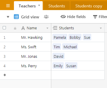

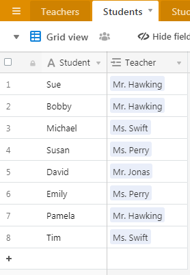

Ok, so you should only need to switch 1 of the fields in a table to a linked field, the twin field will be auto-created in the other table(as illustrated below).
Let me know if I overlooked something.
To start, I created these 2 tables:
Then I changed the teacher field in the Students table to a linked field to the Teachers table, and this is what I get:
Note: I did not create the ‘Students’ field in the teacher table, that was automatic when I changed the ‘Teachers’ field in the other table to a linked field
