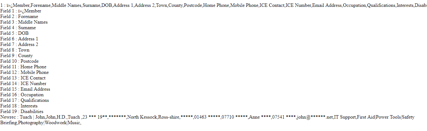

When I export values from a table I get three weird characters at the start of only the first line which contains the field names.
My first line looks like this
Member,Forename,Middle Names,Surname,DOB,Address 1,Address 2,Town,County,Postcode,Home Phone,Mobile Phone,ICE Contact,ICE Number,Email Address,Occupation,Qualifications,Interests,Disabilities
Is this a bug?

Good morning and thanks for the reply.
  To create the file I simply use Airtable's 'Download CSV' menu choice which has no options and store the resulting CSV file on my Windows laptop.
  When I open the file in Notetab the characters are not visible but when I process the file using a local server side scripting language, the characters appear. (All I am doing at this stage is to isolate the field names and then parse out the corresponding field values whilst removing the " characters as my scripting language has a problem interpreting fields enclosed by that character.)
I can probably strip out these characters but just wondered why they are there as this has not happened before in all the years I have been working with CSV export files.
I have checked the process on three different browsers and all give the same result.
Thanks again.

Hello again
  I renamed  a fresh copy of the downloaded CSV file to test.txt and opened it using Open Office Writer and the characters are there so must have been written by the Airtable download process?

I am on Windows 7.
The process I used was to (a) download a CSV file from Airtable (b) rename it to test.txt and then © opened it with Open Office Writer so no browser was involved.
I would offer to attach the raw file for your perusal but not allowed.
Appreciate your help but so that I can carry on with writing the required script, I have just worked round the issue by chopping first three characters off the start of the first line in the file.
Risky I know but hey, what’s life without any risk!
