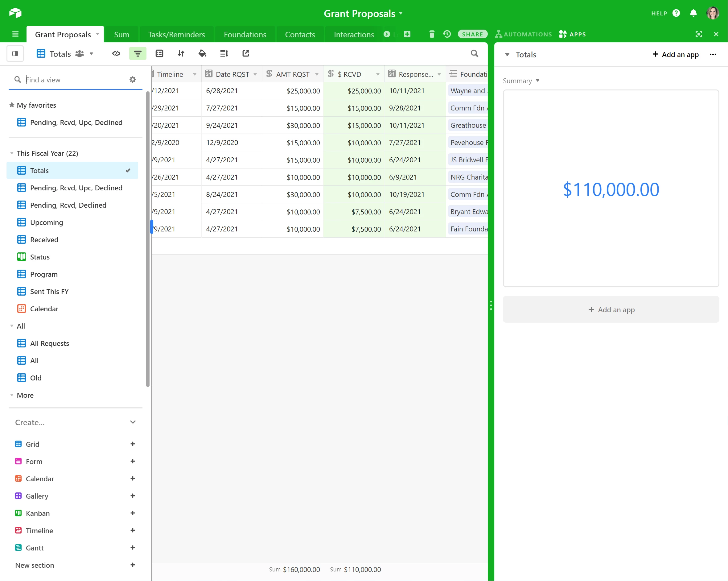

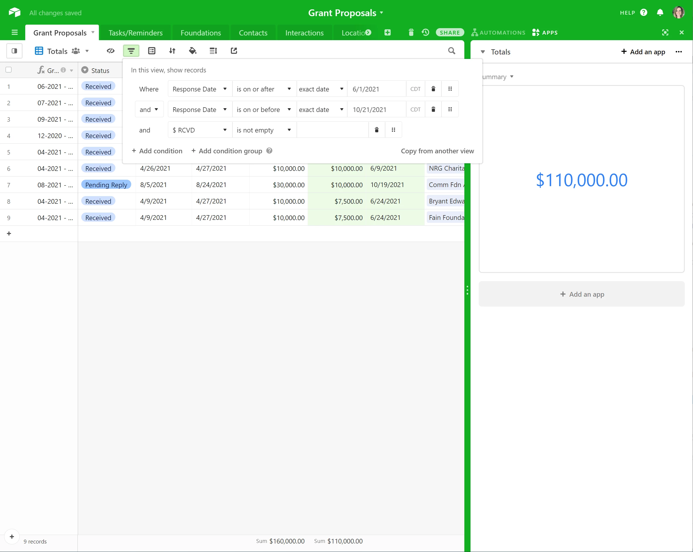

1. Create a view in table 1 where the filters contain 2 date fields, then you use ‘is on or after’ ‘exact date’ and ‘is on or before’ ‘exact date’ and Amount Rcvd (your $ field name) ‘is not empty’. You can then see the total at the bottom every time you enter that view. You can also easily change the dates in the filter when needed.

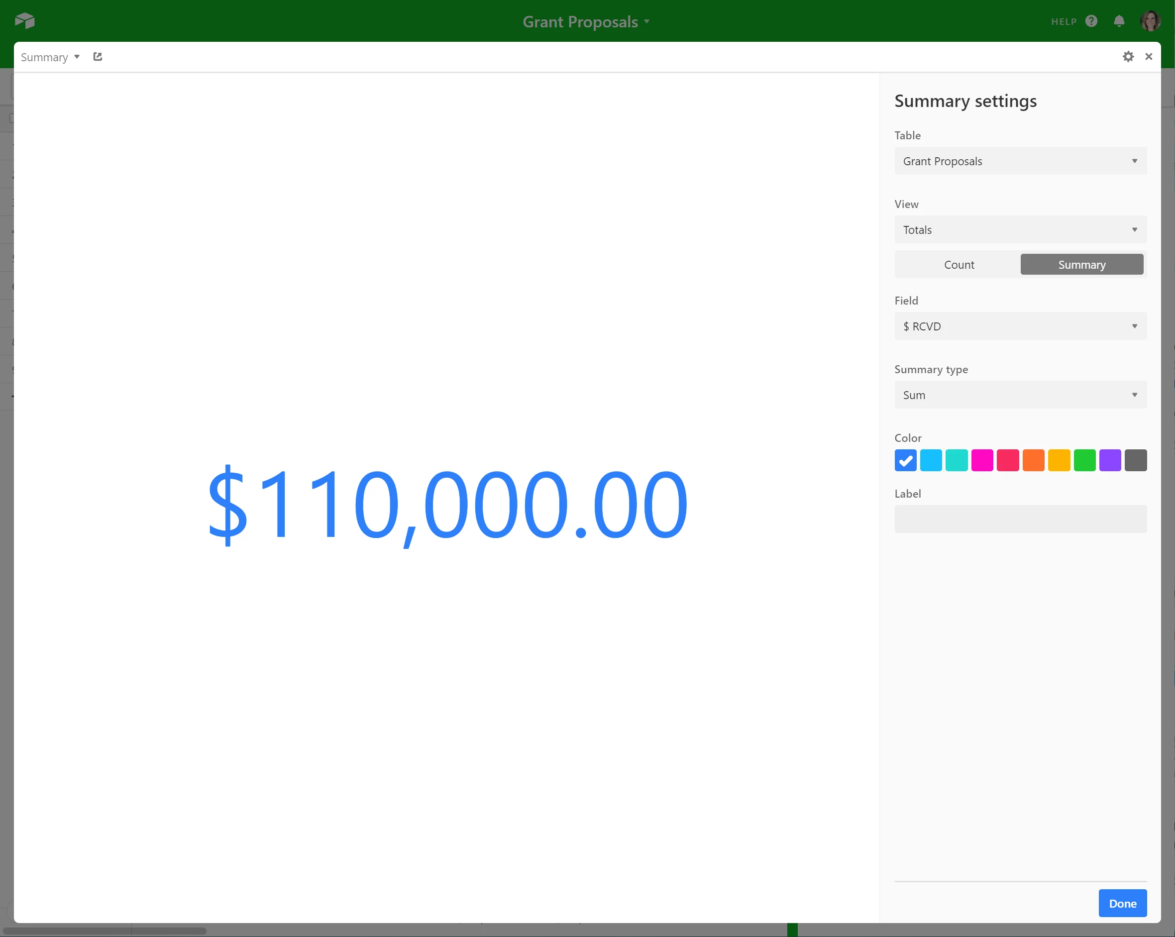

2. Create a Summary app based on that view

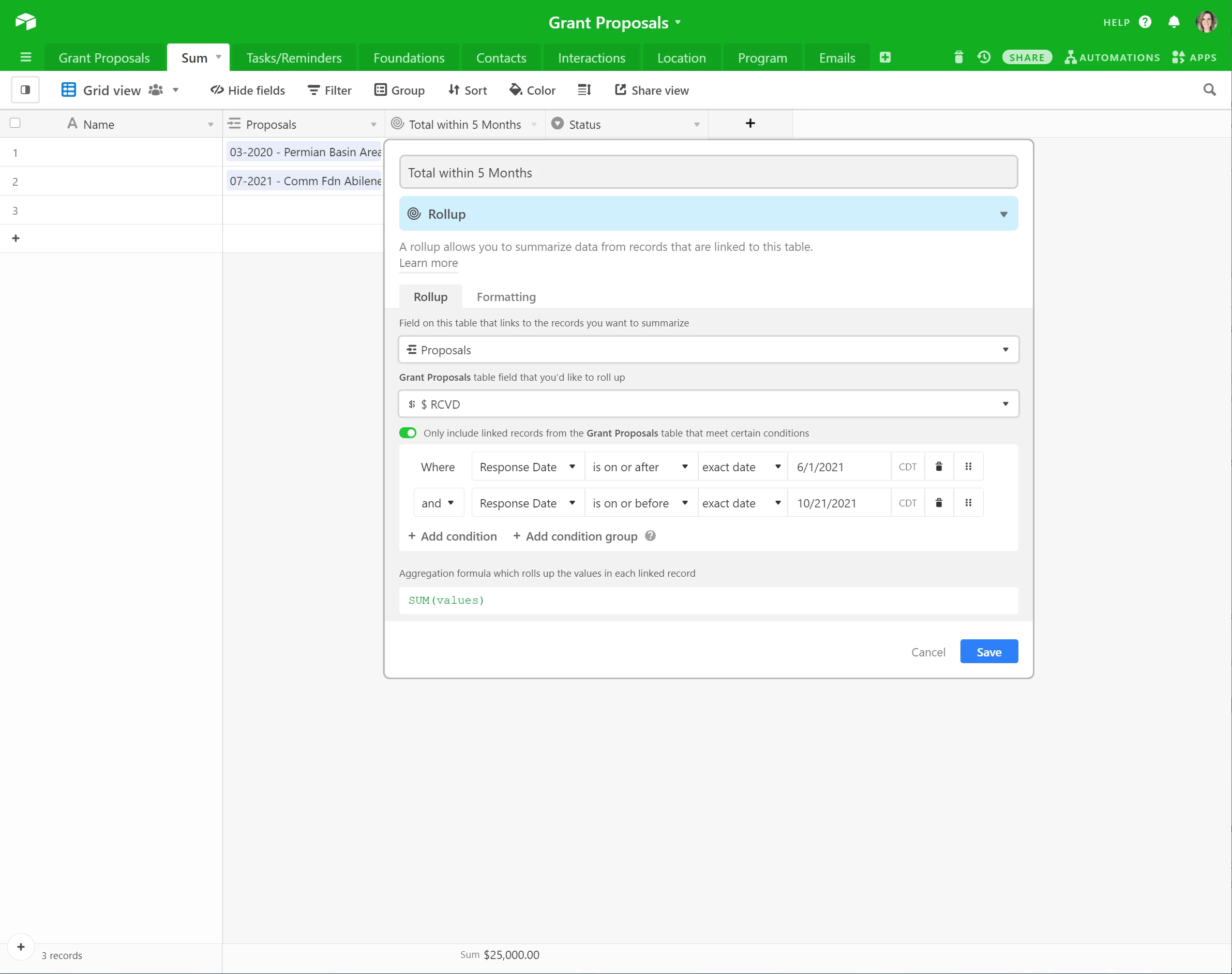

  1. Create a Linked Record Field in your 2nd tab that links to the Contributions table. Create a Rollup field that pulls in the Amount Received then filter it where the Date Received ‘is on or after’ ‘exact date’ and ‘is on or before’ ‘exact date’. Add SUM(values) to the Aggregation field
