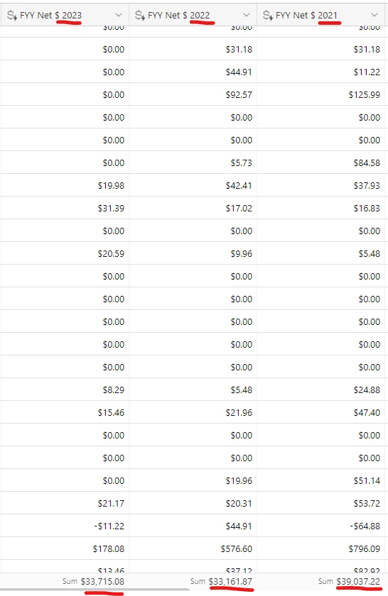

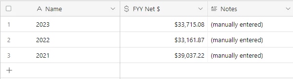

Thanks for providing a response here. Is it possible to do this if your columns are grouped? I want to add the sums of each column for each group to another table in the same view.
I'm having a similar issue.
I can do the rollups on another table, but I can't figure out how to sum across years (as records) down a *single* vertical column (field). Instead, I still end up with 2023 rolled up in one column/field, 2022 rolled up in the next, etc., which is essentially what I started with in the first place. (See attached image.)
I'm trying to arrive at a neat, tidy little summary table; example of a manually entered version attached. (And yes, I've spent hours and hours on this as well, from various websites, YouTube videos, Airtable help, etc.)
