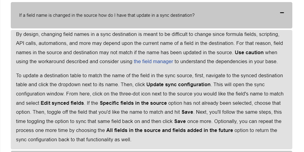

Hi @rtrevor7767, I've just found a reply of Airtable regarding this topic.
https://support.airtable.com/docs/getting-started-with-airtable-sync

This is not a solution to the problem given by the author, but rather an explanation of why Field Names are not synced for a Synced Table.
Although it may be difficult, a solution is technically possible and should still be considered for a Feature Request.

I have a solution to this issue!!!
  1. Rename the source field.
  2. "Hide" the source field, causing the target fields to disappear
  3. After all target fields actually disappear (when syncing is complete), unhide the source field.
  4. The target field will reappear with the new field name
  5. NOTE 1: THIS WILL NOT AFFECT ANY FORMULAS! Try it! Test it!
  6. NOTE 2: This WILL definitely affect all places where you are filtering, grouping, sorting, coloring, automating, linking etc to this field, because once it disappears, it is removed from all those.
  7. Test it with caution, but it works for me!
