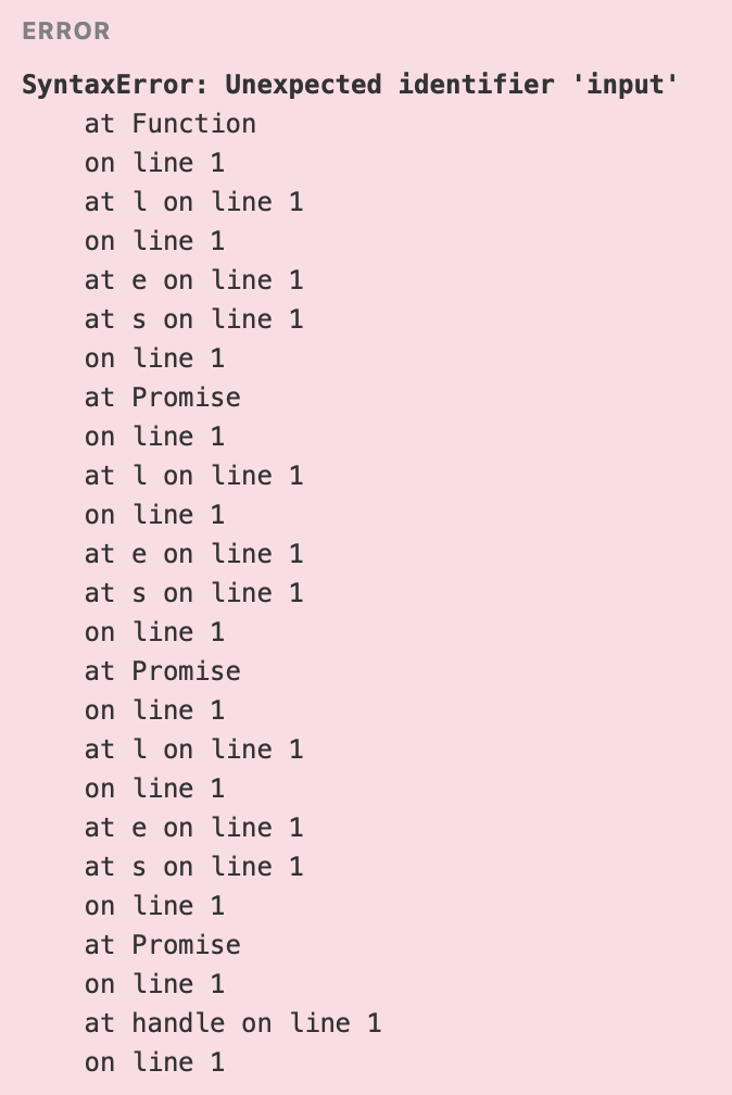

Hi all,
I’m diving into the wonderful world of Airtable scripting with a custom CSV import script that does some data interpretation and creates links to other tables. Starting point was the CSV import example.
I managed to get that working and added more functionality.
Now, I keep getting an error that I cannot seem to solve:
But the editor shows no red markings, and the first line of my script is a comment!
Here are the first few lines of my script:

Best answer by Emar_Vegt
Since the script was working before you added more functionality, what code did you add?
When in the execution of the script does the error occur? Before you upload the file? After uploading the file, but before showing the button? After the user clicks a button?
Have you checked the format of the CSV file that you are importing?
It is also possible that the error is occurring in the code that parses the file, and not your code.
The error happens before anything is displayed in the output window. So it means the error is actually triggered on or before line 2 of my script, as line 2 would output a string to the window.
In my mind, that rules out any other part of my code, right? How can it have to do with the additional functionality or the CSV file if the script does not even get to that part?
I’ll try deconstructing my code further.
Edit:
I started chopping the code with block comments like Justin suggested and found the culprit:
Apparently you can’t have an input.buttonsAsync() function inside of a map() function.
I was doing some data processing with functions inside of map(), which works fine, but in those you cannot ask for user input – that triggered this nondescript error right from the start of the script. Removing the input.buttonsAsync() from inside map() solved it.
So for reference, an excerpt of what works:

That’s been the case from my experience. Whenever I see a really long error message like that where all errors are on “line 1”, it’s never line 1 of my own code. It generally means that something in the script parser on Airtable’s side of things is encountering an error. It’s still related to your code, but it just makes troubleshooting much more difficult.
I suggest testing the code in sections. Use the block comment option to block out most of the end of the code, leaving only a small portion at the top un-commented. Once you know that works, move the start of the block comment to expose a few more lines of your code, and test the script again. Lather, rinse, and repeat until you’ve found the part of the code that triggers the error.
If you’re not familiar with block comments, here’s a quick rundown.

Thank you for coming back and explaining the problem. It is easier to understand the error now.
The reason the error happened before anything was displayed is because it was a syntax error. The grammar of the code was wrong, which prevented any of the script from running.
The error is for “Function” without a name because the function inside your map is an anonymous function without a name. The error is at “line 1” because the error was at the first line of the anonymous function. The error is a problem with a promise, because the input functions return promises.
I really appreciate you coming back with your solution because it has helped me improve my own coding and debugging skills.

Not necessarily. Remember that you’re required to use the await keyword before calling asynchronous functions/methods like input.buttonsAsync(). If you use that asynchronous call inside another function, that function also must be defined as asynchronous. In other words, if you define format_date as an asynchronous function…
async function format_date(data) {
    // code here, including await input.buttonsAsync()
…your example should work if you call that function using await, like this:
let new_records = csv_rows.map(csv_row => ({
    fields: {
        'Employee Name': csv_row['Employee Name'],
        'Period end date': await format_date(csv_row['Period end date']),
// and then write new_records to your table as per the CSV import example.
Admittedly I haven’t tested this (and don’t have time to fully do so right now), but I think it should work.

I tried the suggestion by Justin.
The compiler does not like the await format_date() inside map():
SyntaxError: Unexpected identifier 'format_date'. Expected '}' to end an object literal.

And it seems calling an async function inside map() also throws an error:
ERROR
L: Can't create records: invalid cell value for field 'Hours Clocked'.
Cell value has invalid format: <root> must be a number
    at spawnErrorWithOriginOmittedFromStackTrace on line 1

For now, I will remove the button interaction here and continue with my other issue, namely that the automatic CSV interpreter can’t handle commas as decimal notation (4,5 becomes 45)…
The new Excel file support does a better job with that when using the built-in import function for a base, but there is no documentation about the differences between loading an Excel file in the scripting app vs loading a CSV other than the statement that ‘.xlsx’ files are supported. Simply replacing the file type causes other errors during the interpretation stage.
Good to know. I just tried a more detailed test, which pointed out what I believe is the core issue: the map method has no mechanism for calling an asynchronous function. It assumes that any function passed—anonymous or named—is synchronous, and there’s no way to override that assumption and tell it to wait for an asynchronous function’s return for each item.
That said, you could still get what you want by doing the manual version of what map does automatically. Make format_date an asynchronous function as described above, then use this:
let new_records = [];
for (let csv_row of csv_rows) {
    let end_date = await format_date(csv_row['Period end date']);
    new_records.push({
        fields: {
            'Period end date': end_date
I ran a test similar to this, and it waited for the button click for each item in my original array.
