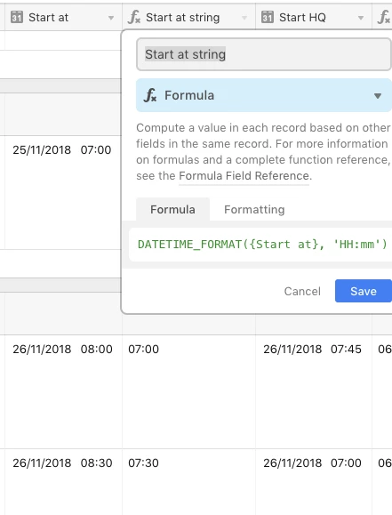

Update:
Here is a screenshot showing the bug.
