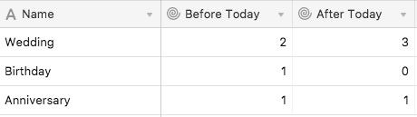

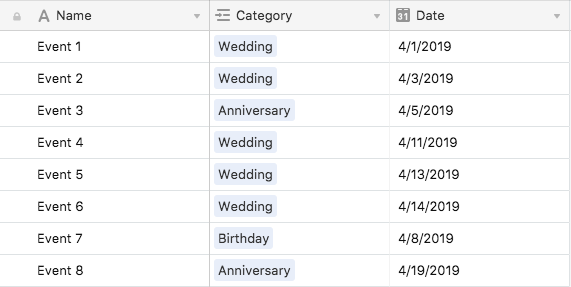

Here’s what I came up with. Let me know if this works for what you need.
In your [Events] table, make a new formula field named something like {Before}, using the following formula:
IF(Date <= TODAY(), Date, 0)
Right-click on the {Before} field, change its name to {After}, and change its formula to this:
IF(Date > TODAY(), Date, 0)
Feel free to hide these fields, as they’re only going to be reference for the next step:
In your [Category] table, add a new Rollup field named {Before Today} that points to the {Before} field in your [Events] table, using the COUNTA(values) aggregation function.
Duplicate this field, rename it {After Today}, and change the rollup to point to the {After} field in the [Events] table.
Now you can look at the list of categories and see how many fall before today, and how many fall after today. Here’s how my example looks (some fields are hidden/cropped):
