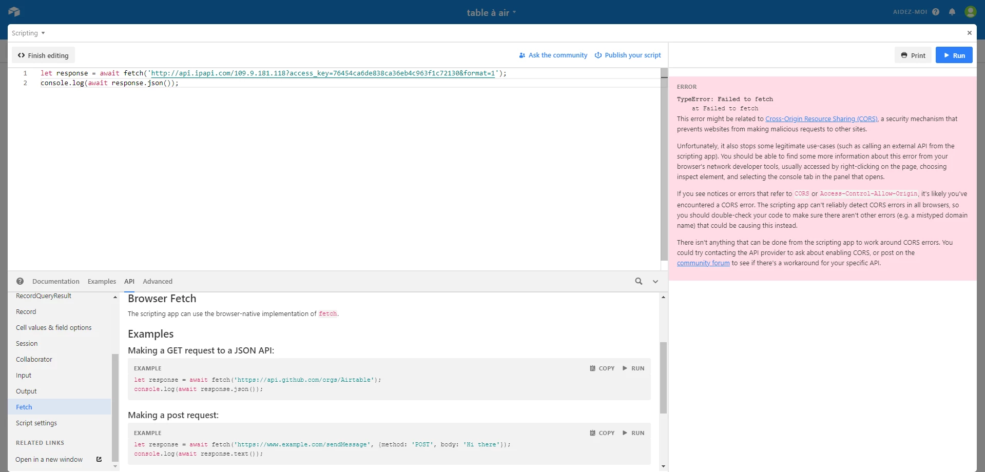

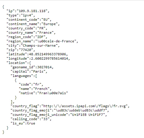

  • Jan 25, 2021 9:27 AM UTC
Hello, excuse me for the delay in responding.
I give you the screens of a very simple code for the recovery of the json from the API.
This is what the API returns to me:
This is what the airtble script returns to me (in the script I only display the json)
thank you
Bill_French
  • Jan 25, 2021 2:59 PM UTC
thank you
And how [exactly] are you able to see that response? Performing a GET from a browser using this URL?
http://api.ipapi.com/109.9.181.118?access_key=76454ca6de838ca36eb4c963f1c72130&format=1
If so, you cannot expect this to run in a script in Airtable (or any system for that matter) because the service level you’ve signed up for at ipapi.com doesn’t provide HTTPS, a key security requirement for anyone engaged in API integration via Airtable.
Until such time as you enable HTTPS on that account, you will spin your wheels attempting to make this work.

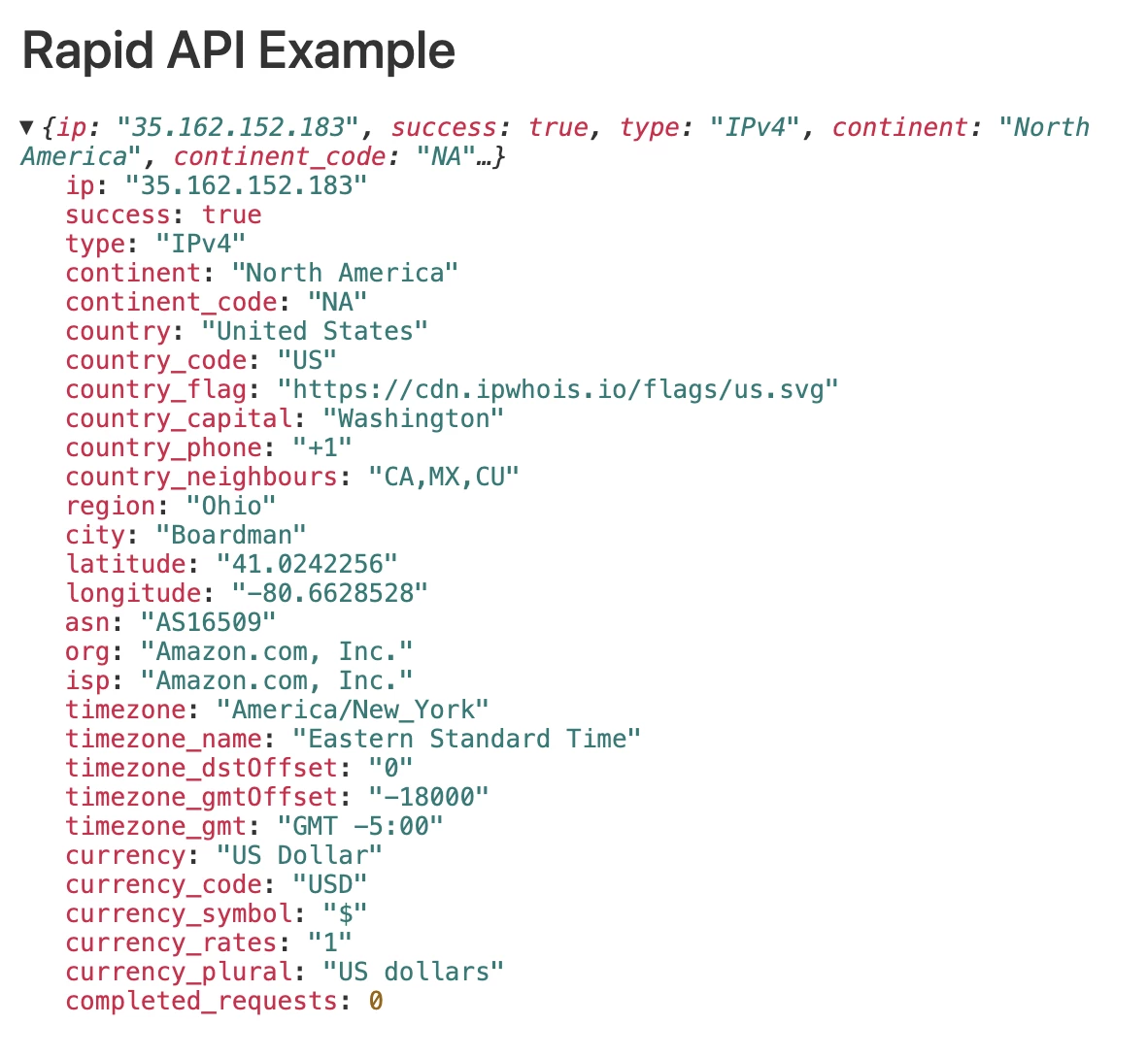

Works fine for me. The problem is not Airtable - it’s your code. You need to do something to show the response from the API call.
output.markdown('# Rapid API Example');
let host      = "ip-geolocation-ipwhois-io.p.rapidapi.com";
let accessKey = "c7bd31779emshe2f681be6a371a4p111f02jsn3cbcfa506bae";
let url       = "https://ip-geolocation-ipwhois-io.p.rapidapi.com/json/";
let options   = {
    "method": "GET",
    "headers": {
        "x-rapidapi-key": accessKey,
        "x-rapidapi-host":host
await fetch(url, options)
    .then((resp) => resp.json())
    .then(function(data) {
        output.inspect(data);
    .catch(function(e) {
        output.markdown(e.message);
