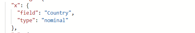

I’ve moved on to using Vega-Lite in the hopes this can be solved, but this is where I’m stuck. This is the section relating to the x-axis:
Is there a way to split the values from the “Country” column (the Lookup Column), using commas as the delimiter? And then grouping data for each country together?
I found out ‘{splitChar:,}’ could be an option, but I have no idea how this would fit within the above example, or if this is even applicable in this case?!
