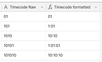

Hi Community,
I’m resurrecting this thread to add another precise request on the subject.
The Duration field type is nice, but it does not auto format the data typed in.
With hundreds of IN and OUT time to log from footage files, I’d love to just have to type the numeral digits without the :
So if I type 123 it logs 1:23, and if I type 10123 it log 1:01:23, for hours:minutes:seconds, etc. as it works for example in premiere or after effects when typing numbers in the timecode field.
That kind of auto-formating for timecode, with various framerates presets, would be wonderful!!
Another linked request that would be useful is to be able to import video files just to grab the metadata, without uploading gigabytes of videos, so its not necessary to type the files name, duration, source, etc. manually!
I’m still searching for something that does what I need. But still thanks for what airtable is already!
Will a formula solution suffice in the meantime? It just processes the raw text, but it might still save you some time.
    {Timecode Raw},
    REGEX_REPLACE(
        {Timecode Raw},
        REPT("(\\d{2})", (ROUND((LEN({Timecode Raw})) / 2)) - 1) & "$",
        LEFT(":$1:$2:$3", 3 * ((ROUND((LEN({Timecode Raw})) / 2)) - 1))
With the help of an automation that runs a script, it’s possible to translate this into inline formatting. Normally automations that act on data changes don’t wait for the user to finish editing a field, but I’ve come up with a method that actually waits.
