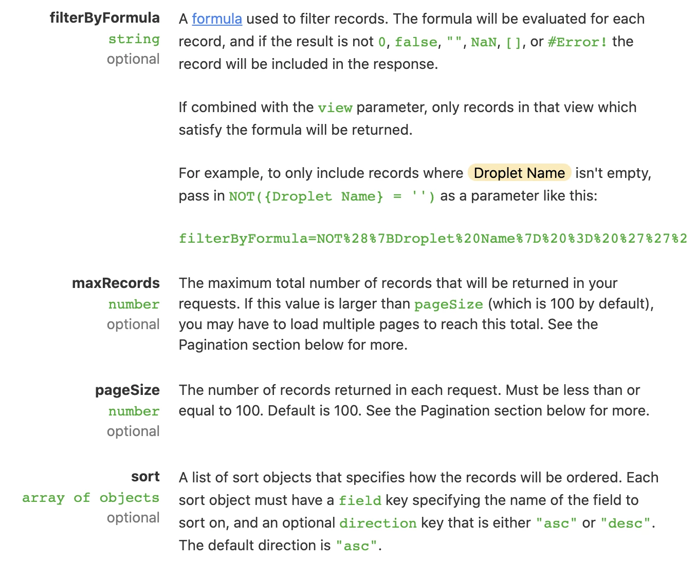

In my “view” (pun intended) you need exactly zero views to achieve your objectives. In fact, any attempt to map 100+ users to specific views (in this case) would likely create more problems than it would solve. Since the Airtable’s API lacks any ability to instantiate views dynamically and managing manually-maintained views is woefully unsustainable, we must find another way.
I believe the answer is in the external app. If it has the ability to ingest a view (presumably using the Airtable API or some other glue-factory service), it also has the ability to request an extract of the data that is not only sorted, but also filtered using such features in the Airtable API.
filterByFormula and sort can be used to create views dynamically, making it possible to tag your data records with a specific user’s name, ID, or any other value that allows the external app to access only those records.
In this approach, you never create views for specific users; rather - you simply allow the external app to identify which user’s records it needs.

Yep - and that number is the view ID - it’s automatically created and assigned by Airtable for every view created. For example, this new API endpoint allows you to get all of the view names and IDs. Then, it’s a matter of using that APU meta-data to construct and deliver the links to the individual users.
I continue to believe that virtualizing a dynamic approach is ultimately going to be more sustainable.
