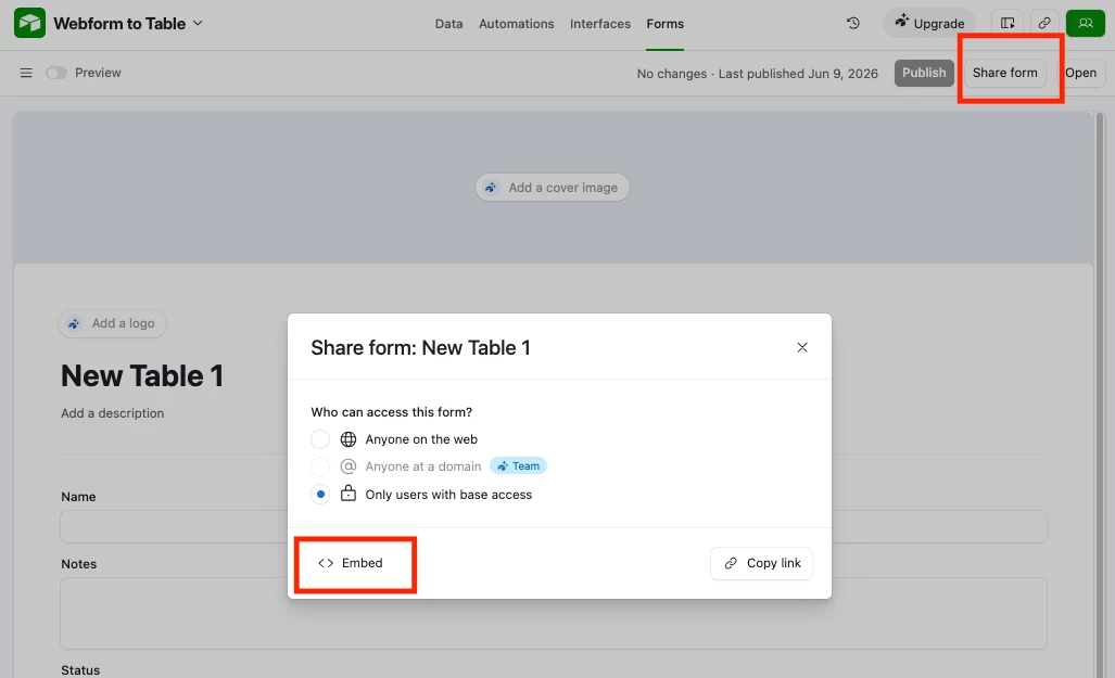

I think what you’re looking for is a standard Airtable form. On your Airtable base go to the Forms tab at the top of the page, follow the steps to build a form, and then get the public share link for people to submit.
https://support.airtable.com/docs/en/how-to-create-a-form-in-airtable
Adding on to what Matt_Shepherd mentioned, are you looking for embedded forms in particular?  That’ll let you put the form inside your website instead of a new tab opening up
https://support.airtable.com/docs/building-and-sharing-forms-in-airtable#embedding-forms
