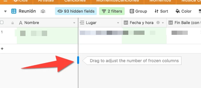

And extend the ‘frozen columns’ delimiter! So you have the image always visible.
  • February 4, 2019
Thanks Elias. Good plan!
