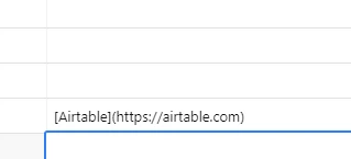

I want to create a link inside my long text field with rich text formatting enabled by zapier.
But when I write
[Airtable](https://airtable.com)
in Zapier I don’t see the Link as a hyperlink. I just see the text:

It’s not Zapier that’s the problem - you are specifying a markdown format that Airtable is incapable of interpreting as a link. Read this thread.
  • Apr 22, 2020 3:19 PM UTC

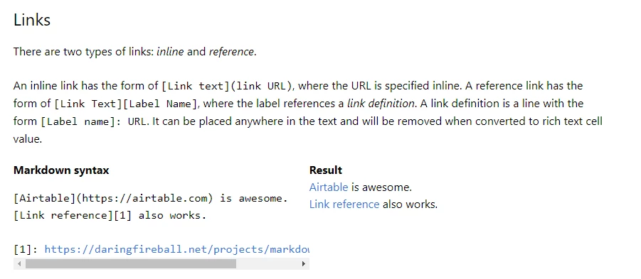

Why is Airtable writing here, I can put in the Links by markdown (or whatever airtable is doing here):
Markdown syntax for Airtable rich text formatting
Rich text in Airtable is based on on a variation of Markdown, a lightweight and readable syntax for formatting. You can use Markdown in the following areas in Airtable: Base descriptions Long text...
But it’s clearly not working for me, even when I use the example given by airtable?

Okay - try using the alternative “markdown” syntax I’ve shown.
It worked for me and I’m simply making the observation – documentation aside – how I was able to get it to work when instantiating links in long-text fields using markdown-like syntax.

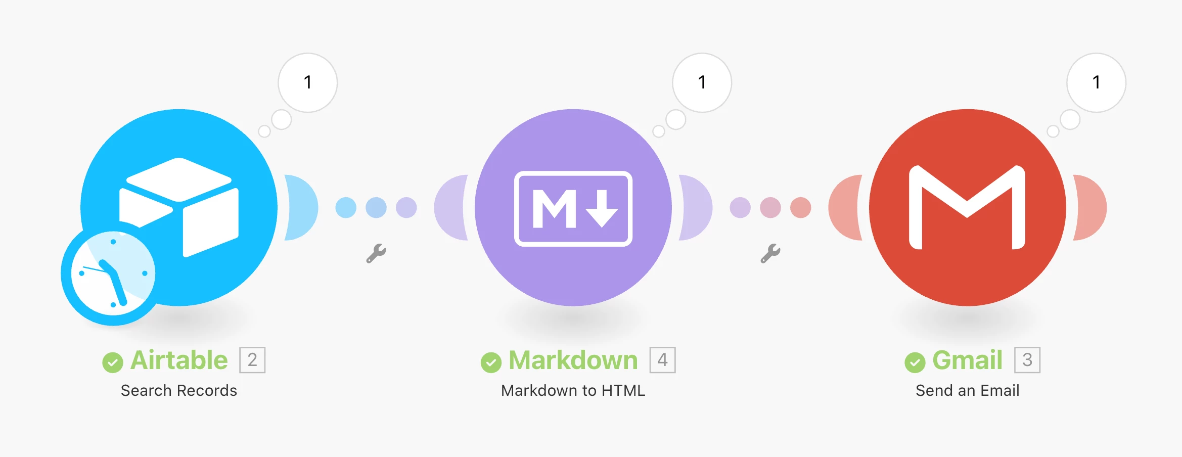

I typically recommend using Make's automations & integrations instead of Zapier.
The reason for this recommendation is because Make is INFINITELY more powerful & customizable than Zapier, yet it is SIGNIFICANTLY CHEAPER than Zapier.
I wrote an entire post here comparing Make vs. Zapier.
Make has a great markdown to HTML module which lets you convert Airtable's rich text fields into HTML, so you can insert that HTML into emails or any other place where you need clickable links.
Take a look at the screenshot below for how easy this would be to setup in Make. (If you’ve never used Make before, I’ve assembled a bunch of Make training resources in this thread.)
