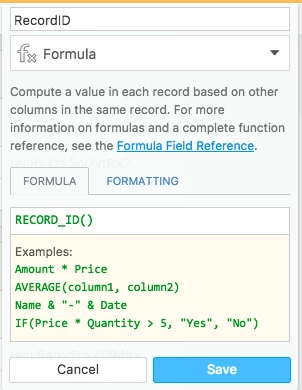

This is actually quite straightforward but seems to require the creation of a new formula field in the Employee table to show the Record ID:

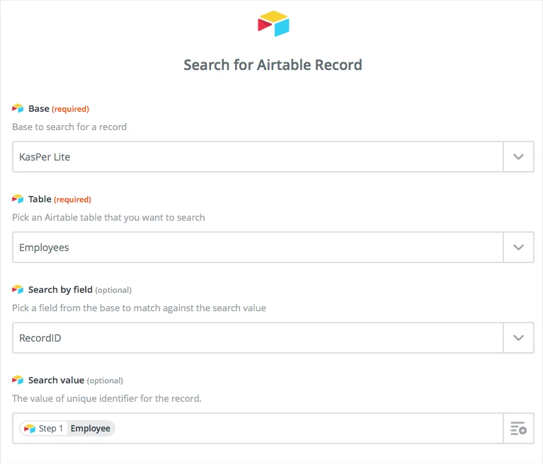

Once you have this you can use a Find Record action in Zapier (based upon a new record trigger in the Holiday table) like this:
Subsequent steps in your Zap will then have access to all the fields in the related Employee record.

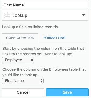

Alternative
There is a simpler (though less flexible way to do this as well - which is to place a Lookup field on the Holiday table to retrieve the field you want from Employees - the down side is that you have to have a lookup field for each field you want to access:
I hope this helps - the combination of Zapier and Airtable is pretty cool!
