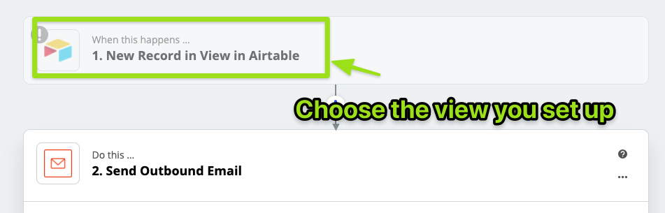

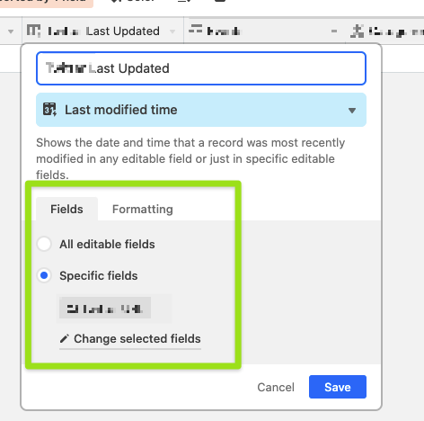

Hey! Yes. The best thing to do is as follows:
  • Create a Last updated field, let’s call it “Last updated”
    • Choose the fields you want (and don’t want) to be considered as “updated” upon creation
  • Create a view in Airtable filtering off this field
  • Create a zap that triggers whenever a record comes into this view
  • The action that should happen after this trigger fires is “email” - And you can email whatever details you want about that record
