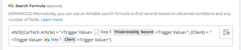

Hi Stephen
Here’s an example of a working formula in Zapier:
Note that Airtable uses the AND() function not the ampersand - and I’m not sure whether the 's are required when you’re comparing to a littereral (0).
Alternatively, you could also use an Airtable view to filter the records for {Tagged RX} = 0 - and then use the Limit To View option in Zapier.

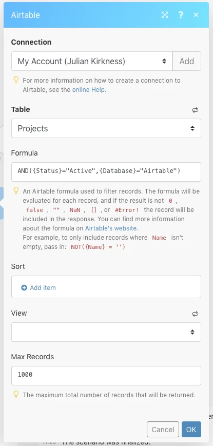

Hi @Andrew_Andrievich
The formula is actually simpler in Integromat - here is an example which goes through my Active Project with Airtable as the database:
Note the Max Records field - this defaults to one - which means that only one record would be returned - so change this to a number large enough to return all the possible records.
Any steps after this will be performed for each returned record (you can also aggregate them etc when you become a bit more proficient).

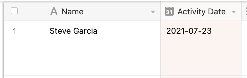

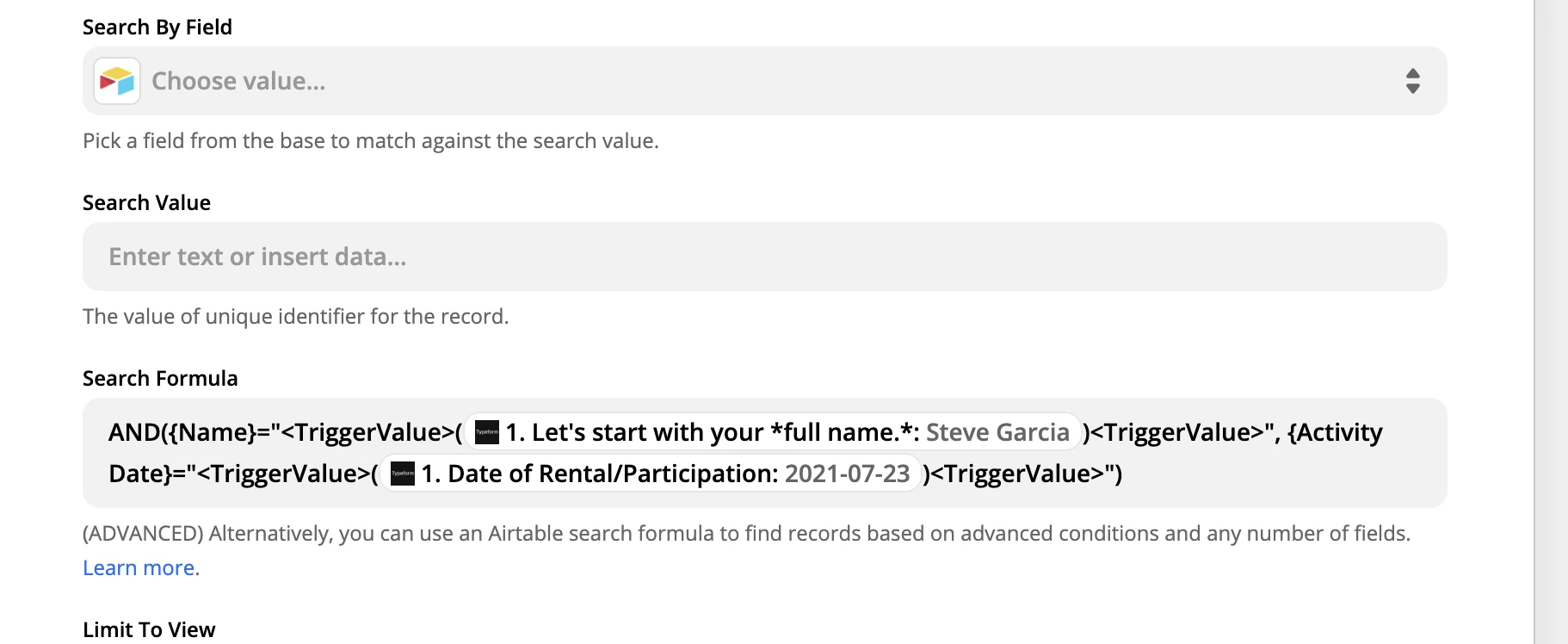

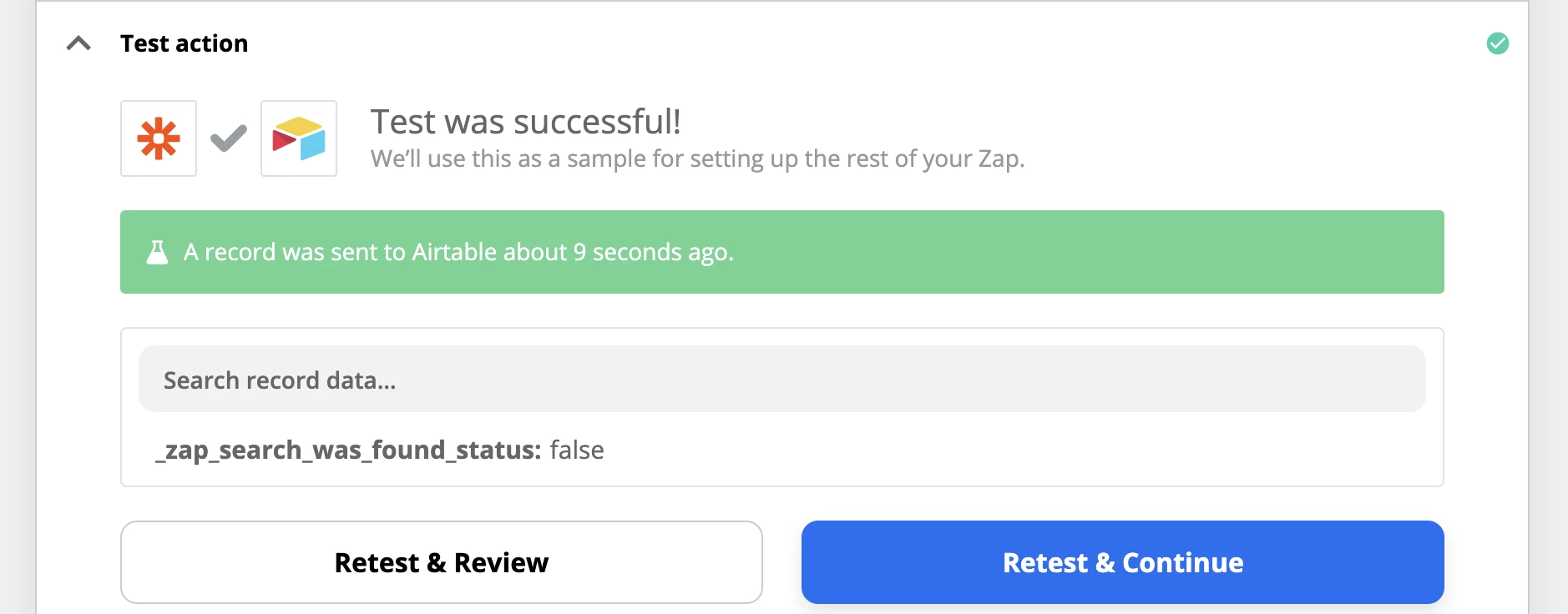

Using search formula to find and match a record based on their name and date, screenshots below. I’m using Julian’s “AND” formula and Zapier keeps creating new records instead of matching the one that exists. Any ideas?
Zap search formula setup:
Record I’m trying to match in Airtable:
Zapier’s test result:

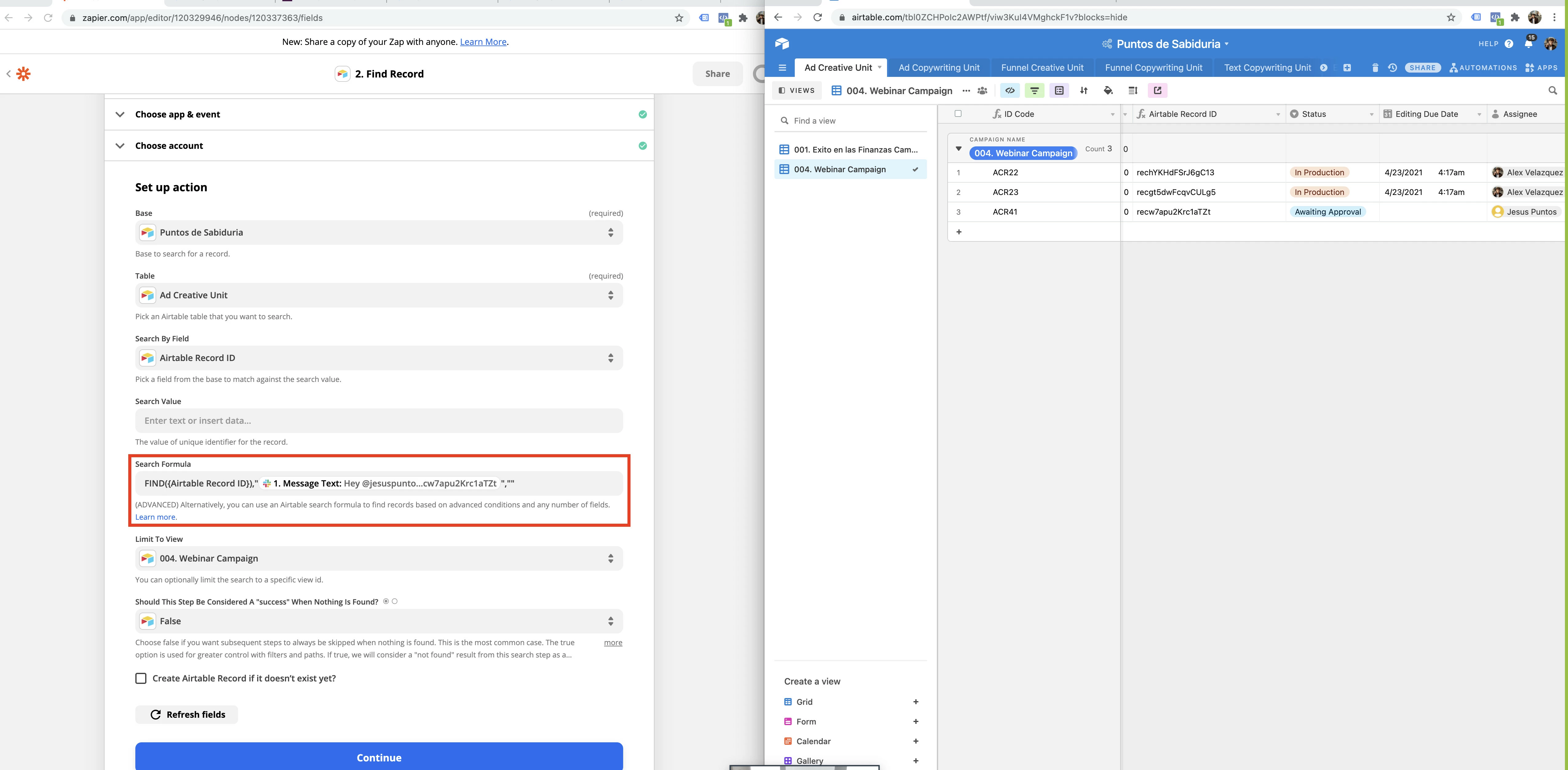

Hey guys, running into the same issue here.
I placed the Airtable Record ID inside of the string of a Slack message that i would like it to find.
I cant get this search formula to work, i am also not a developer myself so i have no business doing this. I’ve been trying to get this to work for 3 days… almost losing hope.
Can you guys help me with writing the formula exactly as you would as a reply below?
Hi, can we have {Status} = “Active” AND {Database} contains “Airtable”?
