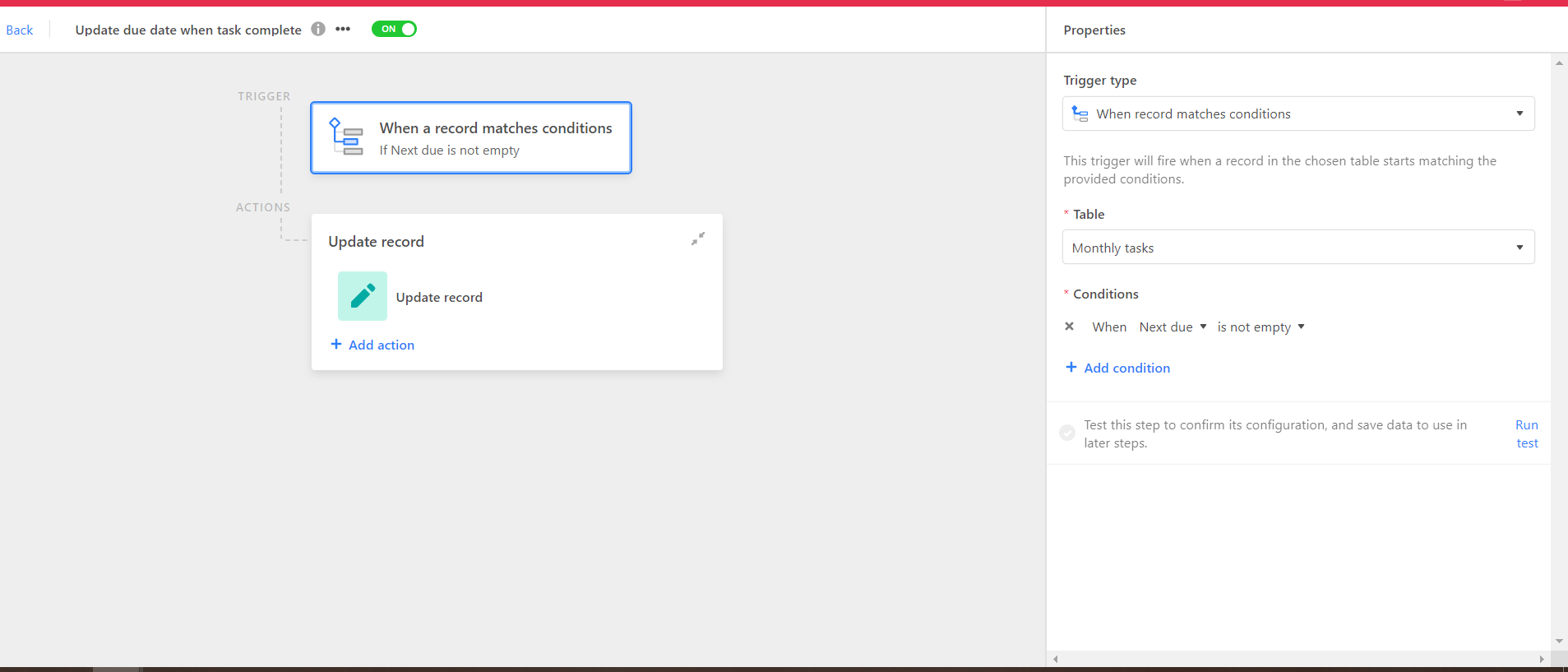

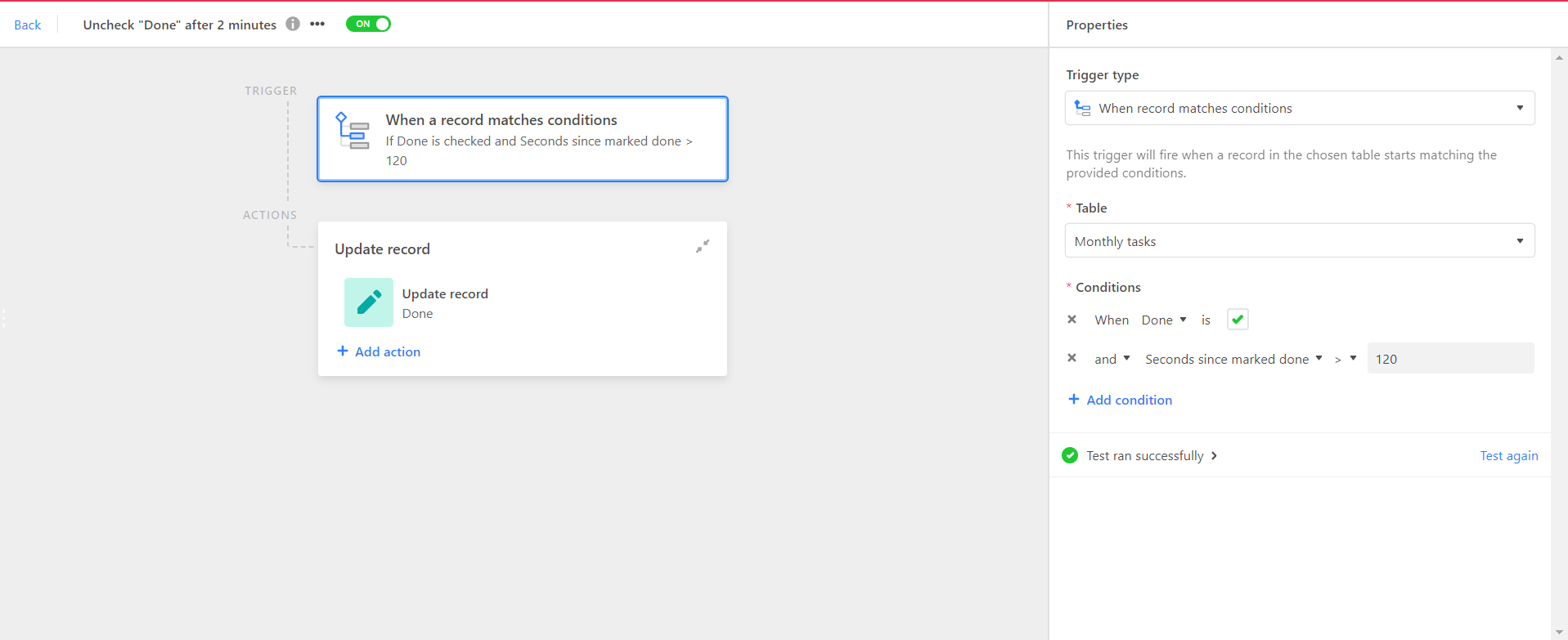

Hi everyone. It just occurred to me that you could use a formula and a couple of automations to make yourself a simple recurring tasks list. All you need is a date field to set the initial due date of your task, a checkbox field for when you mark the task as “Done” and a formula field that adds a specified length of time to the due date using DATEADD when “Done” is ticked. Then your automation will take the date generated in the formula field and replace the original date in {Due date}. A second automation then takes a last modified field set to monitor when “Done” was ticked, and a formula that shows how much time has passed since “Done” was last ticked, and unchecks “Done” after that length of time has passed (I set this to 2 minutes, i.e. 120 seconds). This final step is to ensure the two automations do not interrupt each other (so to speak). Here’s the full set up…

{Next due} - Formula field, using IF({Done}=1, DATEADD({Due date}, 4, "weeks"))
{Last marked done} - Last modified field, set to monitor just when {Done} is modified (i.e. ticked)
{Seconds since marked done} - Formula field, using DATETIME_DIFF(NOW(), {Last marked done})

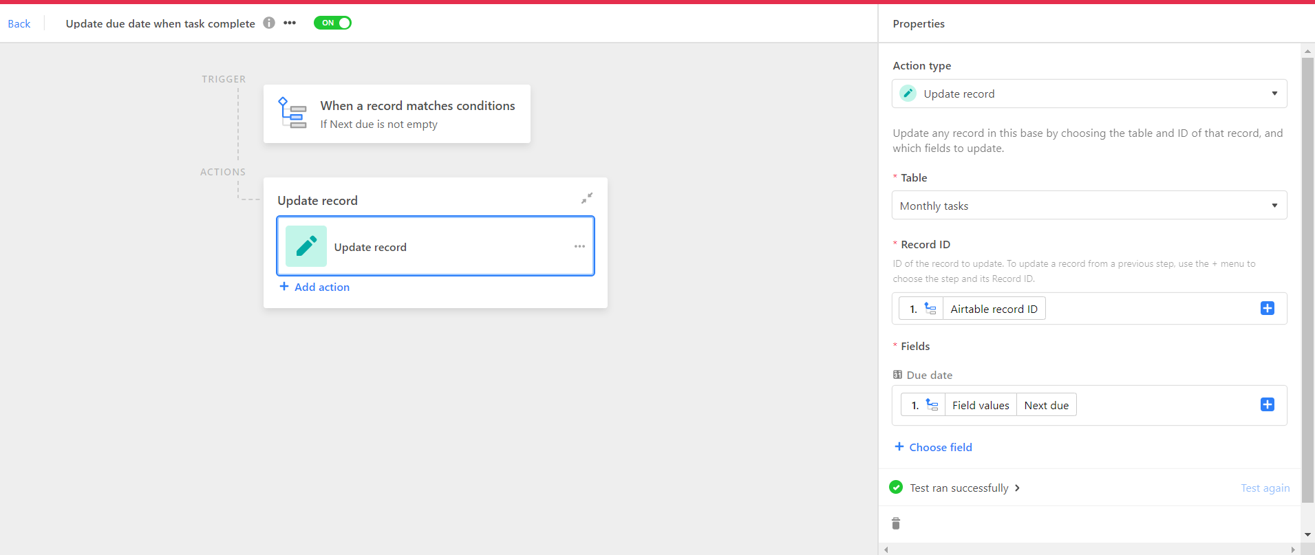

  1. “Update due date when task complete”.
Trigger: When record matches conditions - {Next due} is not empty:
Action: Update record - Record ID: Airtable record ID; Due date: {Next due}:

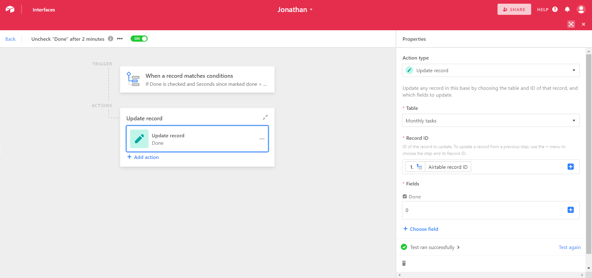

  1. “Uncheck “Done” after 2 minutes”
Trigger: When record matches conditions - {Done} is checked and {Seconds since marked done} > 120
Action: Update record - Record ID: Airtable record ID; {Done} = 0
