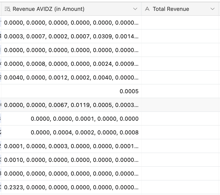

How can I add all the values inside a particular cell in the Revenue AVIDZ (in Amount) and then present as "Total Revenue" hence stating revenue for a particular client?
Revenue field is a lookup field.
Here is the screenshot of the table:

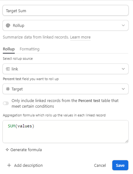

It looks like your "Revenue AVIDZ" column is a Lookup to a linked table.  If I'm seeing correctly you should be able to switch "Total Revenue" to be a Rollup to the same field and set it to sum.  Your names will be different than this example, but hopefully it will help.
  • May 10, 2024
I have now strong faith on Airtable community just because of people like you!
Thanks a lot man. Much appreciated!
