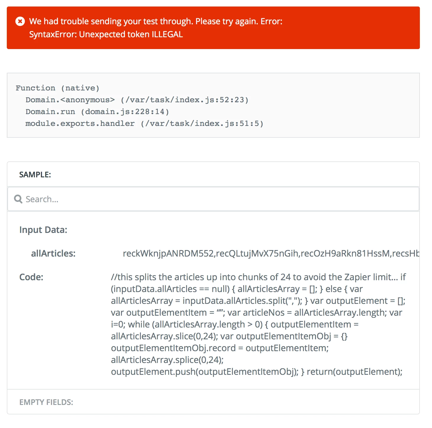

Speaking of your code, I think there was a bug somewhere in Zapier for a week, but its working again for me now. Though when I try to add this second step, I also get an error.
I think you are right about the Line Items. The Trigger app and the Result app both need to support them for it to do what your code accomplishes.
Hopefully Airtable will update their triggers!
I found the issue. It is that the quotes got formatted incorrectly somewhere along the way on this line. Replace them and it works fine.
var outputElementItem = "";
