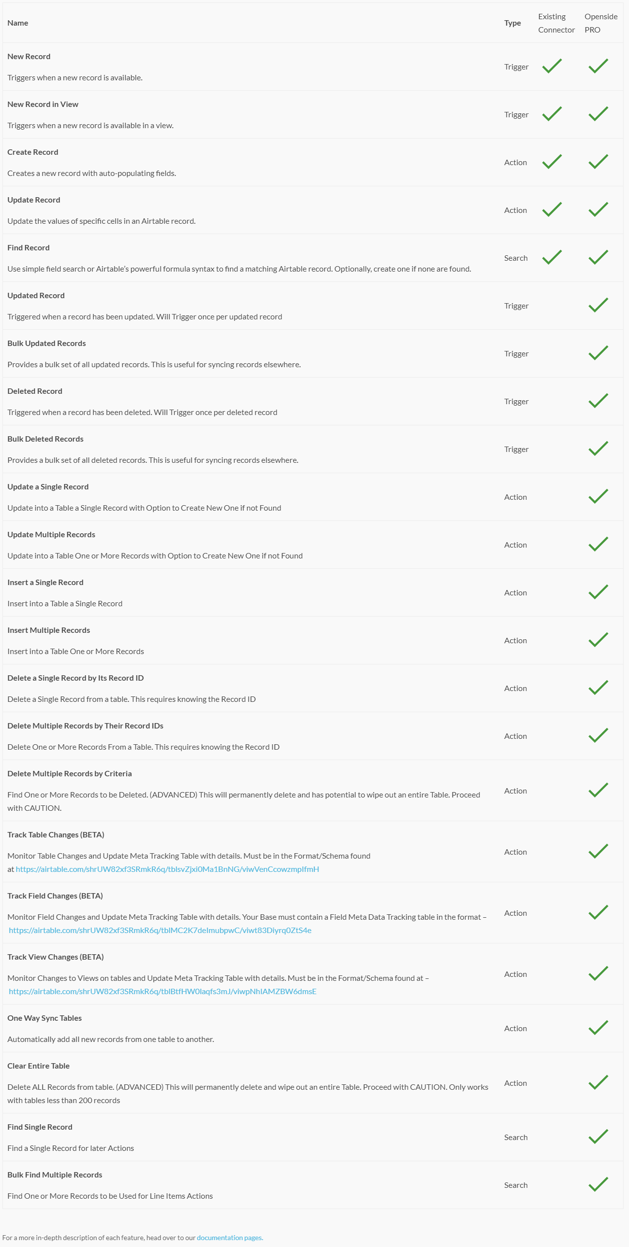

What the connector includes: I’ve put together this chart to show the side-by-side of what the original Zapier connector has vs. what we’ve made:
(click on image to view full screen)
How you can help: check out the connector page, give some feedback here, and if it’s a fit for what you’re doing give it a try (use coupon code SHOWANDTELL for 10% off - offer good till end the month)

How are you able to do things the Airtable API doesn’t enable? In others words, is this Airtable-safe?
  • October 16, 2018
HI Hashim, thanks for the question. Everything we do is through the API. We definitely had to come up with some creative workarounds to get around some limitations but everything is Airtable safe. However, there are still some limitations that may come into play (such as the api limit of 5 api calls/second, or zapier’s limitation of 30 seconds per step) that we can’t get around so that is something to be aware of. Let me know if any other questions.

On your product page it says:
"Updated Record
Triggered when a record has been updated. Will Trigger once per updated record"
  • March 1, 2019
"Updated Record
Fair point. Poor explanation. I’ll improve that.
What that means is that each record that matches criteria will trigger its own zap. Where as our Bulk Triggers will trigger 1 zap with ALL matching records all within a single zap.
However, if the record later matches the trigger criteria, it will definitely trigger again.
