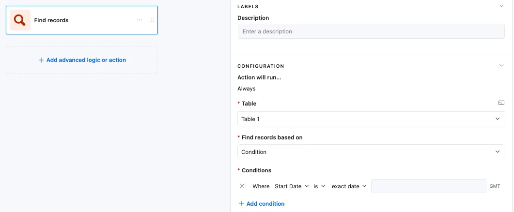

Problem:
The ‘Find Record’ action only lets us search with static values, and so we can’t use another record’s date field value at all:

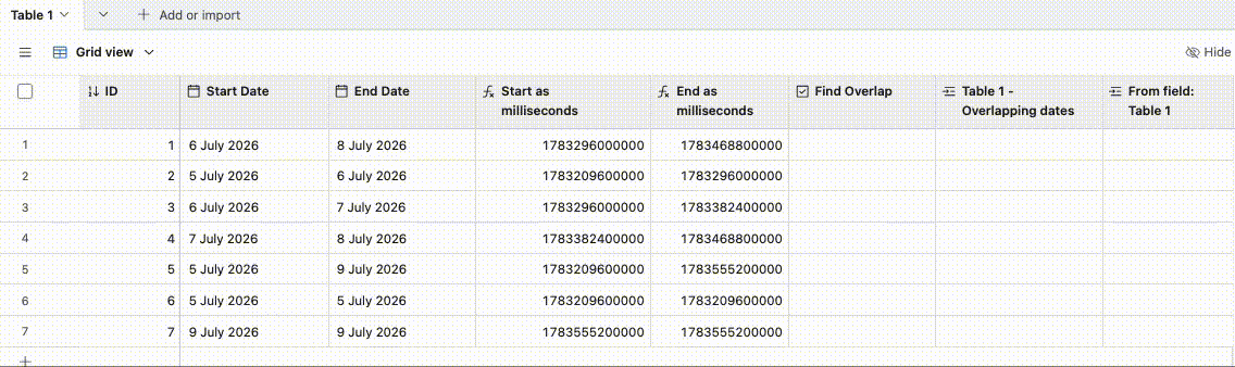

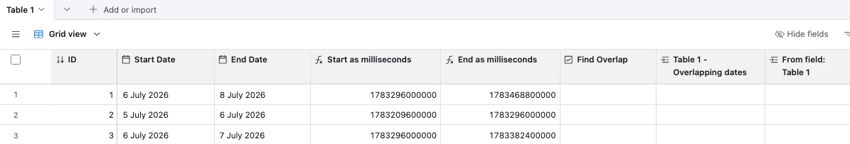

  1. We’re starting off with ‘Start Date’ and ‘End Date’ date fields:
  2. Create a new formula field with the following formula for the Start Date field
    DATETIME_FORMAT({Start Date}, 'x') + 0
    1. Explanation:
      1. DATETIME_FORMAT() with the "x" format converts the date into a Unix timestamp measured in milliseconds (docs here)
        However, DATETIME_FORMAT() returns the result as text, and so we add + 0 to convert the text into a number.  Now that it’s a number, in the Find records action we can use comparison operators like >=, =, etc
        If we left it as text, we’d only be able to use the text operators like ‘Contains’ and ‘Is’
  3. Repeat the process for the ‘End Date’ field
  4. Create a checkbox field to trigger the automation
  5. Create a linked field to the same table.  This lets us link the found overlapping records to the triggering record
  6. Your table should now look like this

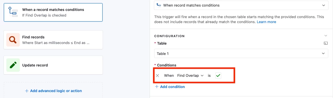

Automation setup:
  1. Create a new automation that triggers whenever the checkbox field is ticked

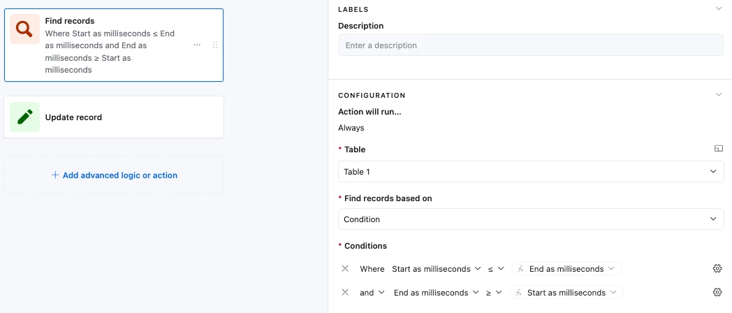

  2. For the Find Record action, set it up to look for all records in your table where:
    1. ‘Start as milliseconds’ is <= the triggering record’s ‘End as milliseconds’ value
    2. ‘End as milliseconds’ is >= the triggering record’s ‘Start as milliseconds’ value

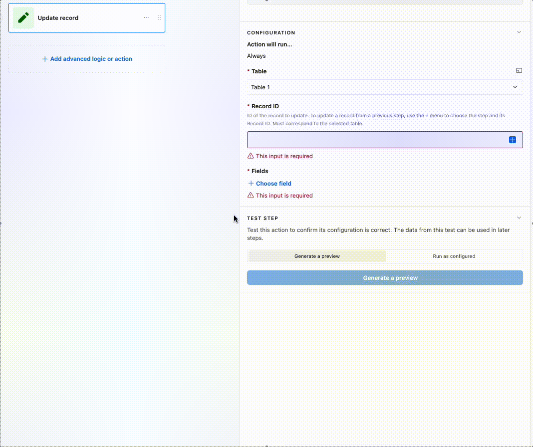

  3. For the final ‘Update Record’ action, update the triggering record with the results of the ‘Found Records’ action, and also clear the ‘Find Overlap’ field
    1. This bit can get a bit confusing, and the gif below shows the following:
      1. Selecting the triggering record’s ID
      2. Putting the results of the ‘Find Record’ step into the linked field
