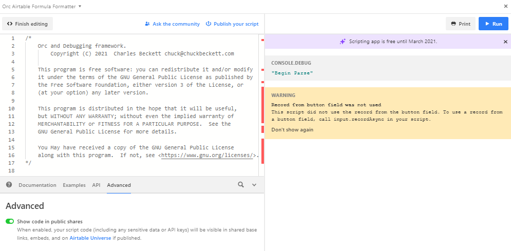

  • You had trouble including the code of the script in your base in the Universe. In order to include the code of the script in the Universe, you need to enable the “Show code in public shares” toggle under the “Advanced” section of the documentation.
  • The editor displays a lot of red bars (and the corresponding wavy red underlines) for the script. The red bars usually indicate that your code contains some sort of syntax error. Even though your script still runs, people will feel more comfortable running code with fewer red bars. Although I have not read all of your code, it looks like a few let or const keywords would clear up most of the red bars.
  • The script does not act on only the single record for which the button was clicked. Instead the script acted on the first record in the view, and then produced unexpected results for additional records in the view.
  • The script produces an error when there is a field name without curly braces that contains an accented character.

Thank you for your feedback, kuovonne, very much appreciated! I apologize for not replying sooner, I had gotten distracted with other things and hadn’t noticed your feedback until today.
I had not noticed the “Show code in public shares” toggle. That’s a big help!
You’re right; there were a lot of red bars in the code that were easily cleaned up. My next release will be syntax error free.
The script invocation was simplistic and didn’t allow for more than one record in the main view. A bit more effort would have fixed that. This is a shortcoming that I will fix in the next release. Rather than have a separate table of examples I will simply enable the code to use whatever row that the user presses the ‘Prettify’ button in, and move all the examples into main view; much easier to use.
Not handling field names without curly braces is a flaw. I’ll see what I can do about that. I will document shortcomings that I can’t easily fix for the next release.
The upcoming release I’m working on let’s you configure the code to output your preferred formatting. It let’s you change the spacing between elements of the formula, wraps long lines according to configurable parameters, and is better documented. It requires you to edit a 'configuration ’ function, but the edits are simple. Hopefully it won’t be too onerous. I’ll produce examples and perhaps alternate configuration settings that people can select.

Hey kuovone, could you provide a code snipit that contains field names with accented characters? I can’t find Airtable documentation on column names and I’m having problems finding accented characters that Airtable will let me use in a field name. Airtable will happily accept just about any UTF characters inside curly braces but I can’t get it to accept field names with accented characters but without curly braces in a formula. Without such a field name I can’t create a test case for it. Thanks!
  • Feb 26, 2021 10:10 PM UTC
I’m finding the same as you now. Airtable formulas are requiring fields with accented characters to have curly braces in formulas.
I remember testing field names with both emoji and accented characters, and that emoji required curly braces, but single-word field names with accented characters didn’t. Either my memory is faulty or Airtable quietly changed things.
Since your script requires a valid formula as input, you can probably ignore this case. (Of course, the best help would be one that could help identify errors in formulas, but that would be far more complex, and even Airtable currently doesn’t provide that.)
