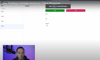

Here is Dan's video : Time Tracking in Airtable Interfaces | Client Showcase - YouTube
Here is Dan Lehmans setup that I would like to recreate :

It caught me off guard, too, but Button fields that are linked to the scripting block don’t work on interfaces. I watched Dan’s video. It’s likely he’s used interface buttons that link to automation scripts to get this done.
Alternatively, if you don’t have access to scripts in automations, you could link an interface button to a checkbox field, connect that checkbox to a last modified time field, and have an automation watch both fields. When the checkbox is checked, have the automation copy the time from the last modified time field into another field and uncheck the checkbox field. You could then have a formula calculate the duration of time from Start to End.
