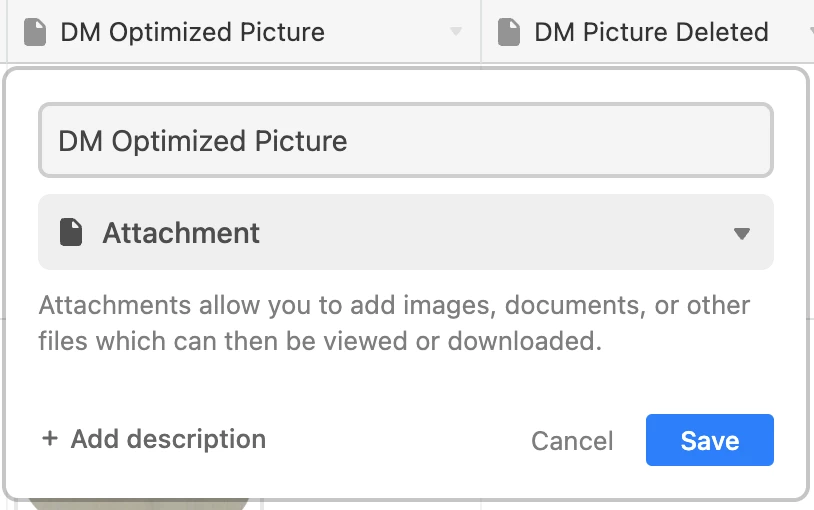

Regarding your solution #1, I can't find the "Keep a history of all versions of this field" option in the attachment field settings.

@subinbabu wrote:
Solution 1: Remove the attachment history. This can be done by going to the attachment field settings and disabling the "Keep a history of all versions of this field" option. However, doing this will delete all previous versions of the attachment and will not be reversible.
 Can you share more about this "Keep a history of all versions of this field" option? I believe that this feature is not available to all users. Are you part of an Enterprise plan that might have access to features that are not generally available? Are you at liberty to share more details of this feature, such as screen shots?

Sorry for the confusion, i mean "Record-level revision history".
