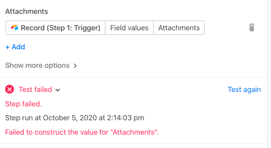

Hi Justin,
I appear to be having the same issue. Within the Gmail Automation, I wish to add an attachment to the email to be sent out. I want the attachment to come from the attachment field of the related record. However, when testing this, Airtable appears to be unable to pull through this field type. See screenshot below:
Thanks for your help.

Welcome to the community, @Tom_Harwood! :grinning_face_with_big_eyes: Check the response I posted in this other thread:
  • October 5, 2020
Thanks Justin, that worked! I hadn’t originally included a file in the attachment field for the record it was using to test before I tested the trigger. I’ve since added an attachment and refreshed the trigger test and now the action test is working.
Appreciate the speedy reply!

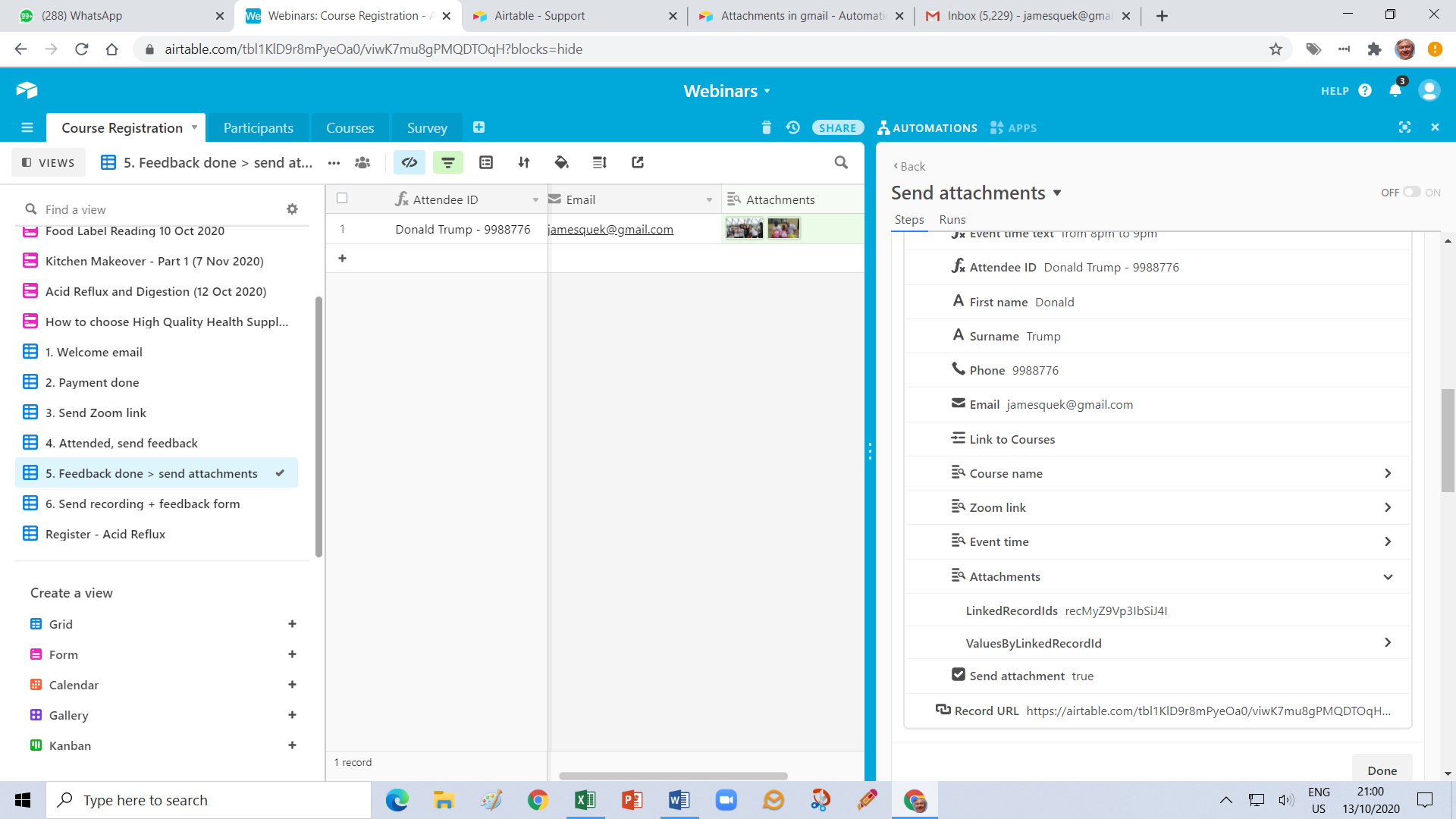

Hi Justin. I am facing the same issue. Have followed the steps above and yet the “attachment” field is blanked out in automation. I checked the test data and 2 attachments appear to be present:
would appreciate some help here.
P.s. my attachments are lookups from another table

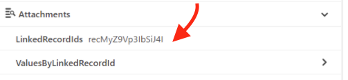

I only see one attachment in the test data based on that screenshot. There’s only one record ID listed here:
The only place where I see two images is in the {Attachments} field, which is not necessarily part of the test data. The test data is the data you see on the right, in the automations interface. You would need to test the action/trigger again to get current data to confirm whether or not both images from that field appear in the actual test data.
That’s been the case since automations were first added. However, the fact that there’s actual data showing for that lookup field indicates that it’s now available.
On that note, @James_Quek, I suggest expanding the “ValuesByLinkedRecordId” item that appears below the list of linked record IDs (after re-testing, of course). That will reveal the actual data that’s available for those looked-up items.
