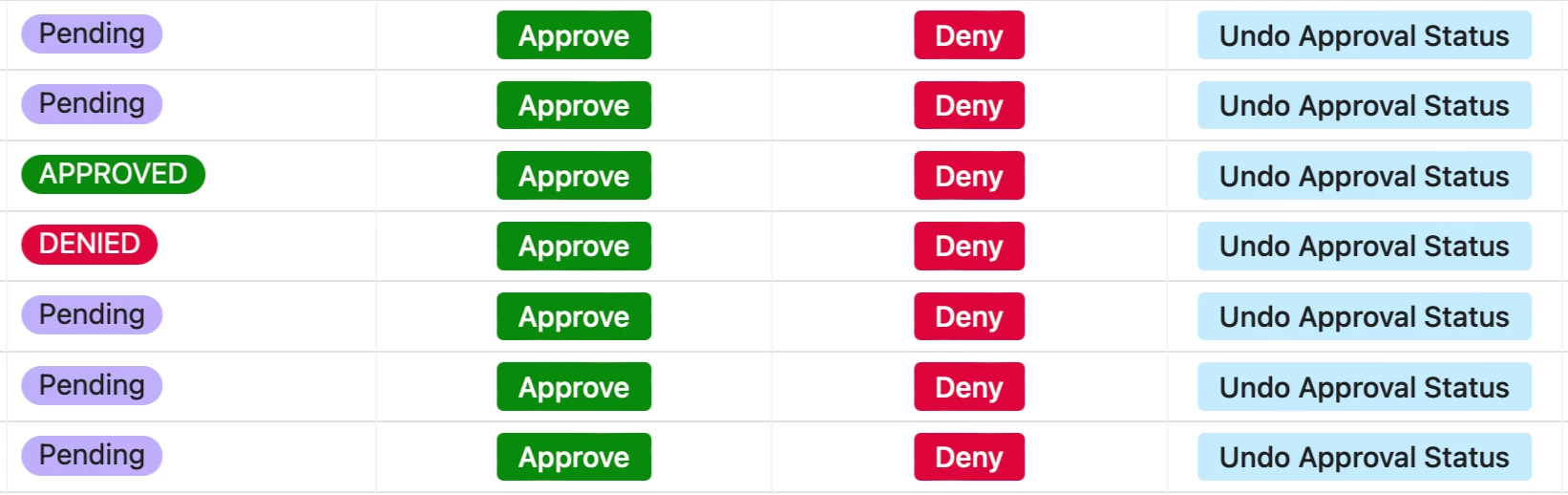

I have a list of 100-200 sign-up's on a shared view (that's embedded in my website, so it "should" update), and I want to have a public user "Approve" or "Deny" each sign-up by clicking a field button (see screenshot) that would update one Select Field in the respective row. This process happens only once a year.

Would it be possible to configure a Field Button to open a URL to a corresponding table (possibly a sync'ed or even two-way sync'ed table) and then use automations to return the appropriate value back?
In my case, clicking on "Approve" or "Deny" would open a URL to send an updated value to the corresponding table that would then update my current table? As I'm typing this, I realize that while the button field: Open URL would enable the button on a shared view, it would also then open a new browser tab... (harumph!)
