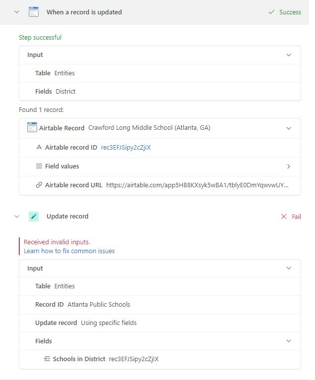

My automation is giving me "received invalid inputs" even though the record IDs look correct in the test runs.
2 steps: when the "District" field is updated (I've entered the school's parent district), then find the District record and update the "Schools in District" with that school record. This test all seems correct:
 I manually updated the district for Crawford to Atlanta Public Schools. It then found the Atlanta PS record and entered "rec3EFJSipy2cZjIX" for Schools in District, which is Crawford's ID.
Can anyone help?

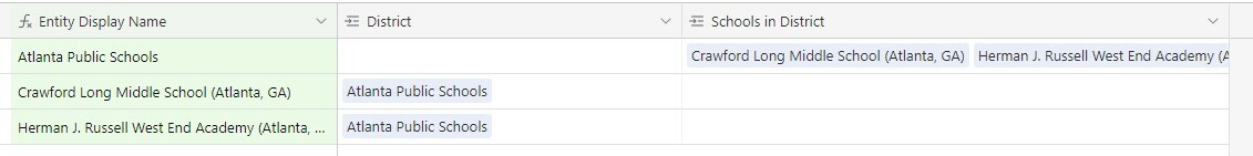

The districts and schools are in the same table. There is no school that appears automatically in a district's record. In my screenshot, I had to add the 2 schools manually. So there is nothing to lookup.

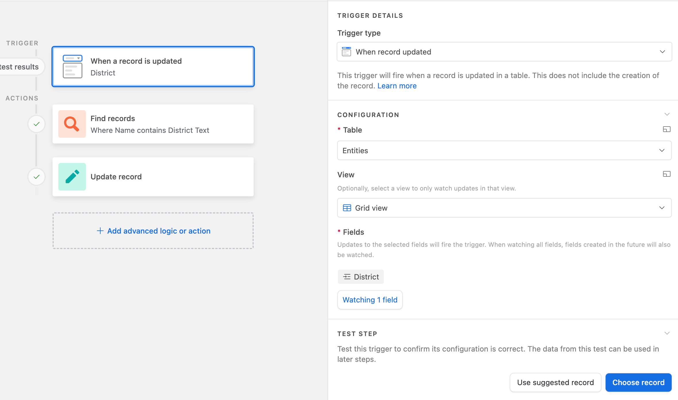

However, if you did want to focus on just one table, you can use some clever helper fields to help make your automation work and get around Airtable's limitation.

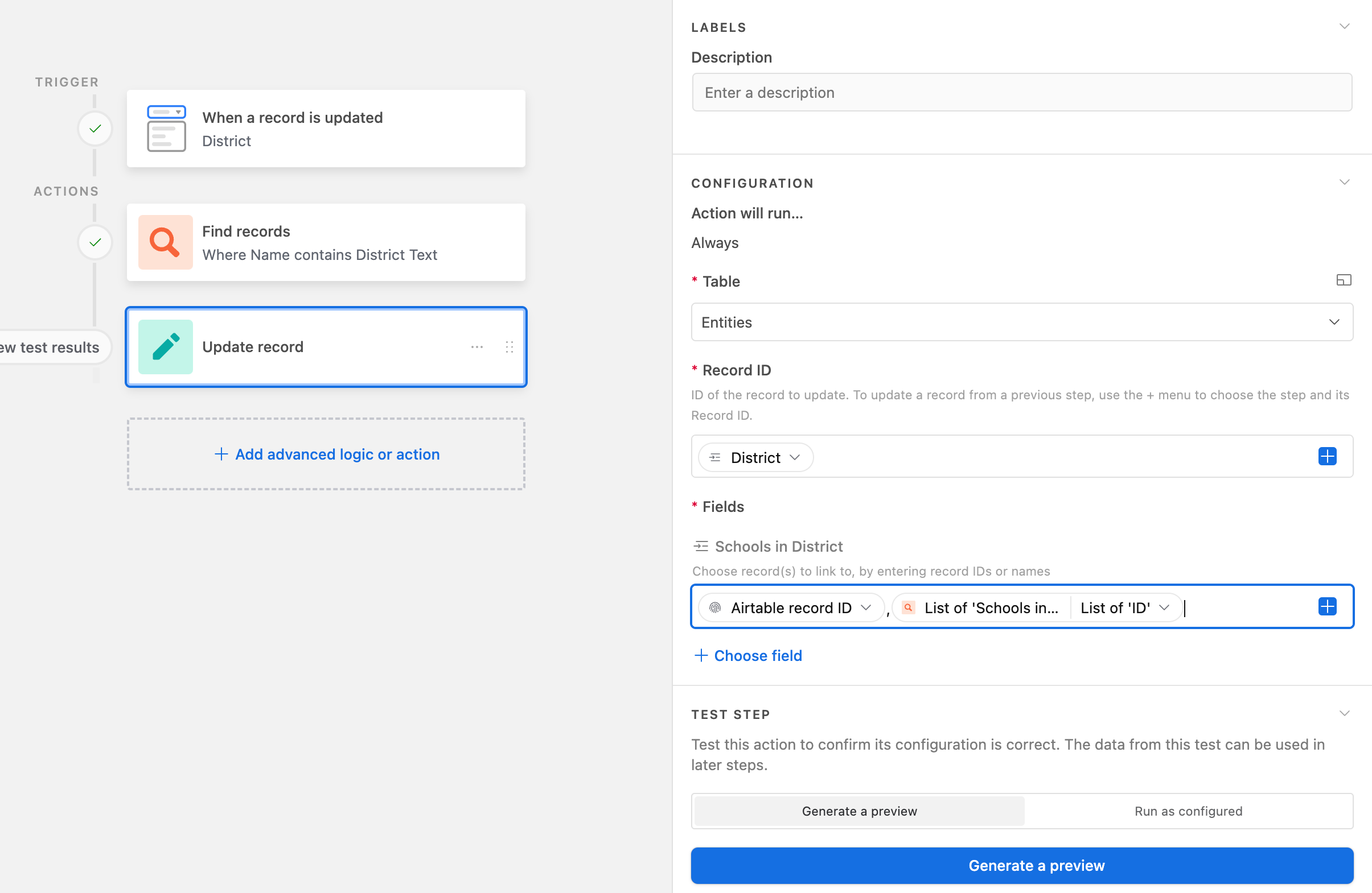

To get around the Airtable automation not accepted the ID from the first step you can set up a helper field to give you the name of the district linked in text. I called it "District Text" as below.
With that set up you can set up an automation as follows:

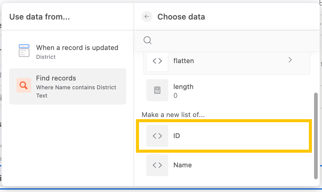

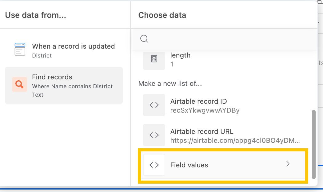

The find record step is so that we can get a list of all of the schools already linked to this district to you in our update step.

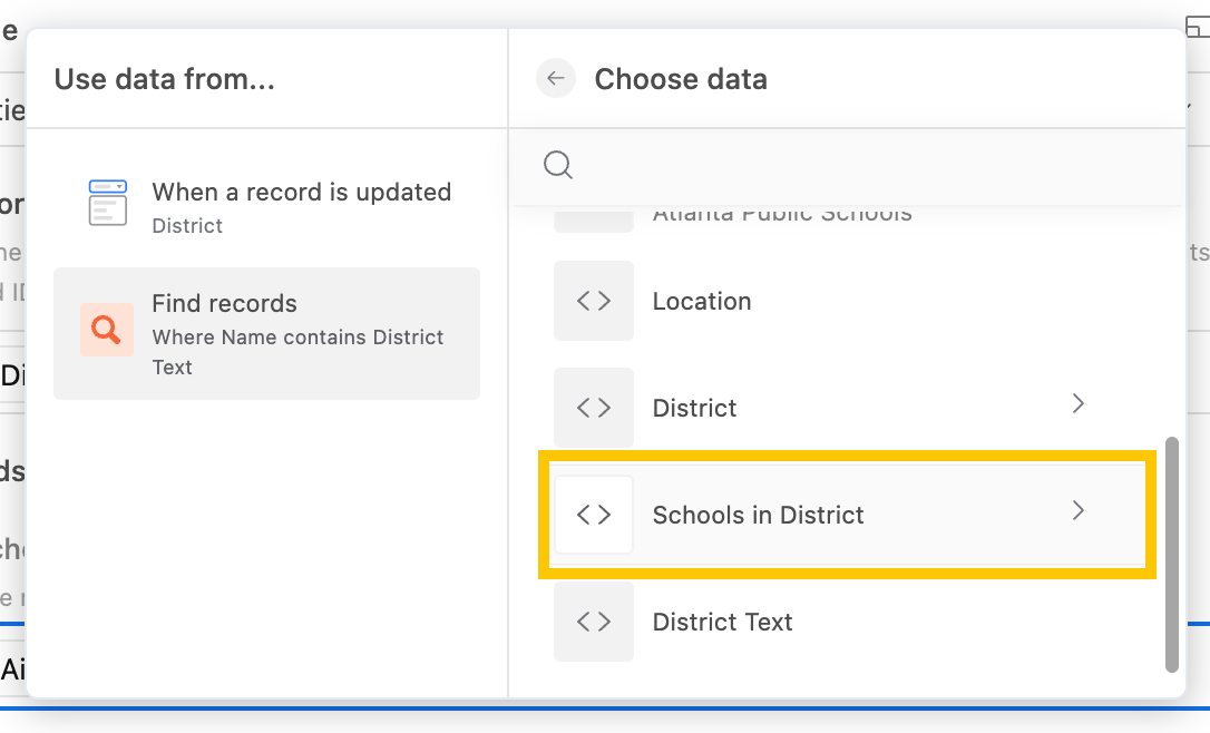

In step 3 the Airtable Record ID is the record ID from the trigger, and the list is from the find records step, can get this element like so:
1.
2.
3.
-Chantal

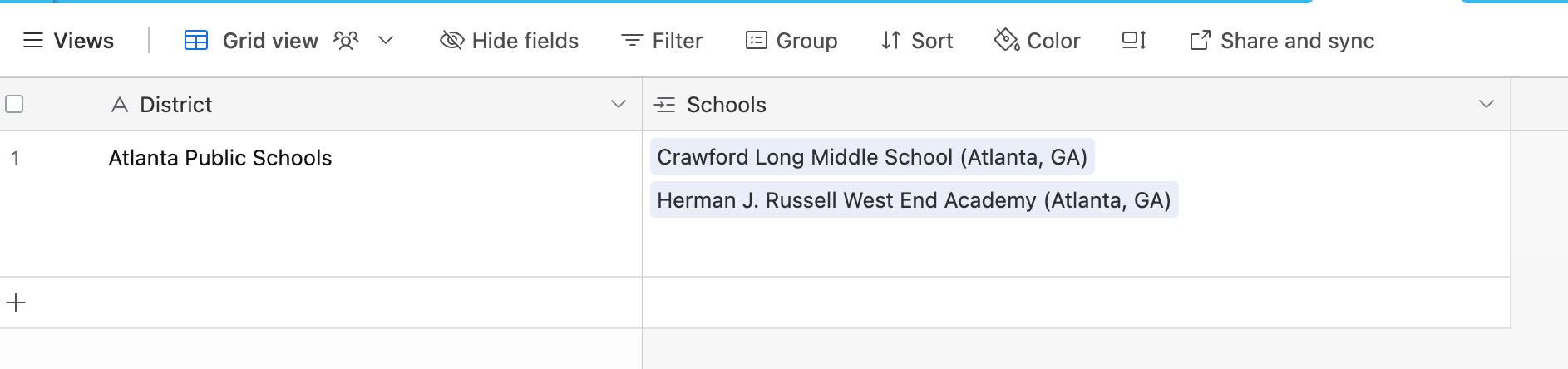

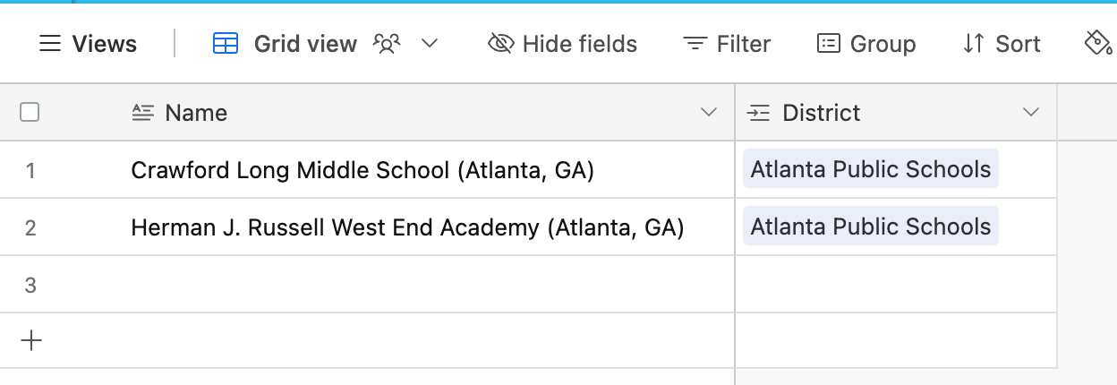

If you are planning to use multiple tables I would recommend splitting your tables into one table to host the District records, and one table for School records. In this case your district is a parent record for many potential schools.
You could then create a direct link between the two tables.
District Table:
Schools Table:

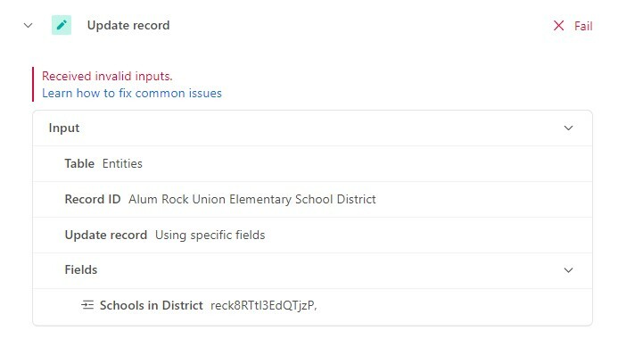

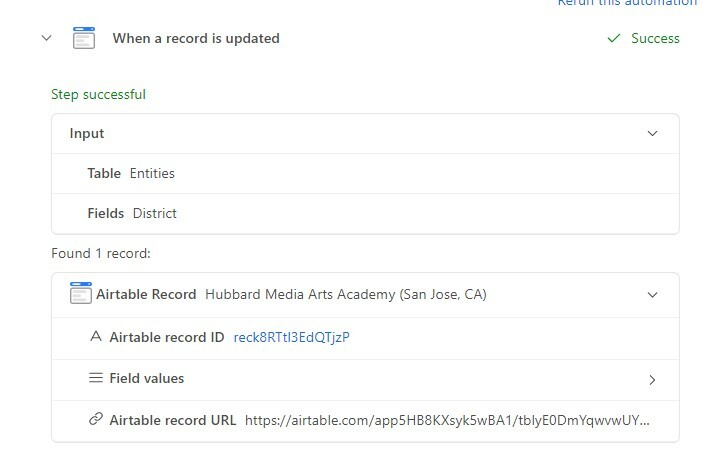

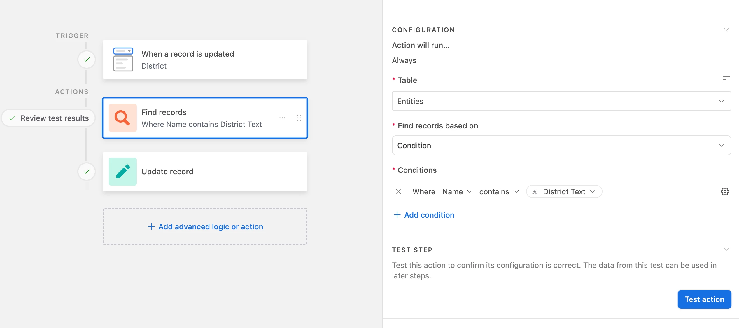

I tired setting up this automation, and I'm still getting my original error of Received invalid inputs.
I updated the district for Hubbard Media Academy to Alum Rock:

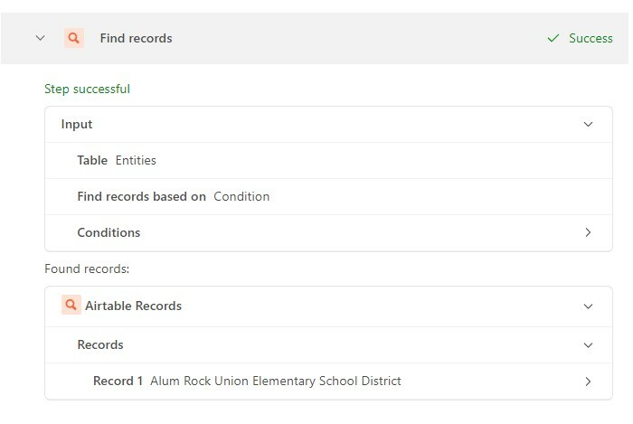

 It ran the find records:
But it's refused to enter the ID for Hubbard - reck8RTtl3EdQTjzP
 I'd like to use this method but I just can't get it to accept the record ID.
