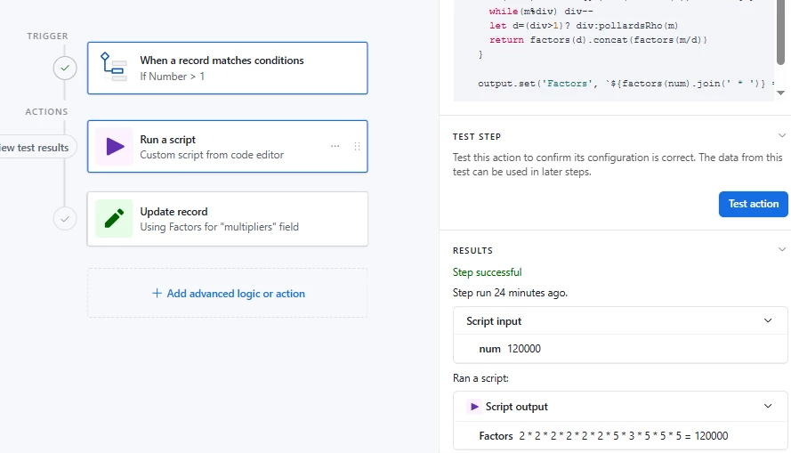

HI,
As former MSSQL DBA, I can summarize that some ‘old habits’ are not useful in Airtable, and it is better to be done ‘in Airtable way’
Usually, you use Script Extensions for something that must be done for the whole table, when you can, for example, select table from dropdown table list, press Run and it doing it’s job.
Automations, on the contrary, often used as a watchdog to react when some data changed/added, and basically it runs for a single record, where change occured, and it does not require any user interaction.
Hovewer, you can install button in your Inteface (Record Picker type) and make it run for selected record. Or you can set up procedure for a whole table, and make it run on a scheduled time, like daily table processing and report.
You may want to create a most part of it using built-in functions, install a small script step to do operation that can’t be done in other way, output it’s result via ‘output.set(“variable_name”, value)’ and continue using this value in further steps.
From start, I tried to find a way to use T-SQL for some operations, it’s not a good idea. Many things can be done in automations without code, using built-in operations. And Javascipt is more convenient and flexible for others.
In SQL, you can UPDATE Field1 in Table1  WHERE Customer=’Value1” for several records or just
UPDATE Field1 in Table1 to update field in the whole table. However, here multi-record update operations are more time consuming. In scripts, they are done by batches 50 records at a time, at a speed like 50-100 records per sec.
Also, Joins in Airtable called Linking and work in a different way. You might want to create unique ID  value for record in each table, but in most cases, you don’t need to do that. Each record has it’s ID retrievable by formula or form record link, but it works ‘under cover’ and user don’t need to know or use it (except you are set up automation, where it is a most reliable way to link). Its very important to properly choose what you will use as a primary field. Note that you can swap fields any time and now it is possible to choose which field to use to display/link.
It’s a long story, but understanding how linking works and how to solve typical beginner problems with it, is a key to succesfully build your base.
