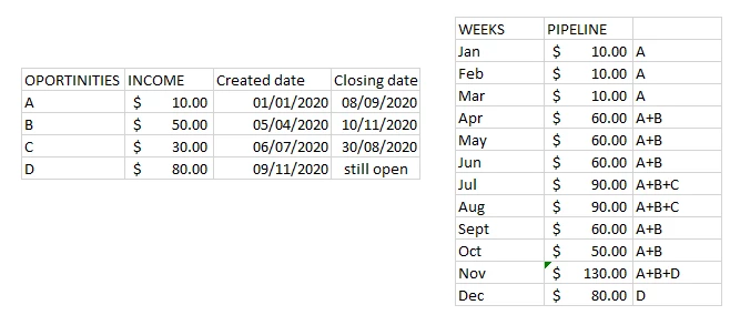

Here is an ilustrated example:
Here is what my two tables in Airtable look like:
What I need is a formula/ script / automation to fill up the PIPLINE colum
PIPLINE = the sum of all open oportunities over time
Hope it helps…
Thanks a lot for the support
Hope it helps…
It’s the last feature I need to get my CRM Operational for my company
Thanks for the images. I noticed that your dates are formatted day/month/year. Are the months of October and November supposed to include A? The text says they should, but the dates and sums indicate otherwise.
You cannot accomplish these calculations using only formula fields. You could get the pipeline sums by completely with a script, but a better method is to use linked records and roll ups. You also need a method of creating and maintaining the proper links. That could be done using automations with a Scripting action.
