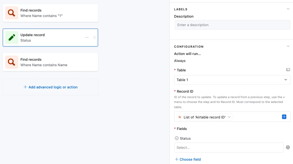

UPDATE: I realised I don’t need a separate Find records step, I can do a direct Update record. There both the lookup and the formula version work.
Would still like to understand how to deal with the Fin records, for future reference.

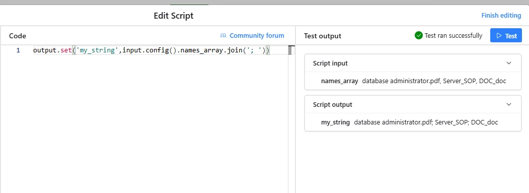

Yeah that’s because ‘Find Record’ is returning an array, not a single result
I usually add a ‘Run a script’ step to convert it into a string / number as needed
​@Alexey_Gusev has a simpler nocode workaround using an ‘Update record’ step and updating nothing for the record in question, and then using the ‘Update record’ step’s output for the next Find Record step.  You’ll need to have a field that you’ve set up specifically for this though so that you can update it as a blank though I think?  Alexey, apologies if I’ve misunderstood what you meant; any errors are my own!

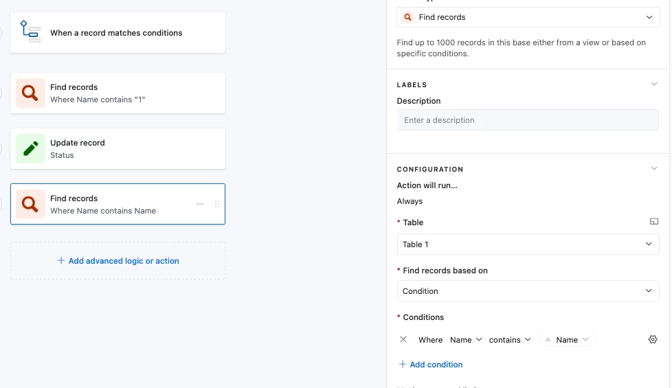

Hm, if you’re doing a single Find Record step and you need search on a lookup field then that works, yeap!
You mentioned you’re doing a Find Record on the results of another Find Record step and I wasn’t able to get it to work for that though.  Any chance you could share a screenshot of your setup?  It’s a lot easier to use and I’d love to start doing this instead!

I would rethink it from the beginning, if it is still a problem.
Find Records is a step that always returns array (including empty array or array with single element)
Lookup is array too. So basically from a single record trigger, when you are trying to use result of your Find Records, you are getting Array of Arrays. IDK what’s the condition on your Find Records, and
of course it depends on your final goal, but looks like overcomplicated way.
It is always better to use proper ways for each type of data,
Like you can use Repeated group for array results, or you can use array of IDs for link field.
But if not, there are many “band-aid fixes”: limit Find Records result to 1, use formula to concatenate, or even one line script step
