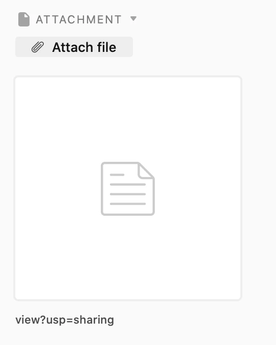

@Stephen_Suen @Kasra, this is all working great for me except for one component: My image in the Attachment field doesn’t display as it should. See screenshot above. The link I am trying to load goes to a Google Drive image file. The permissions are set so anyone with the link can view.
How can I modify the code or the link so it correctly imports the Google Drive link as an attachment?
The link follows this pattern:

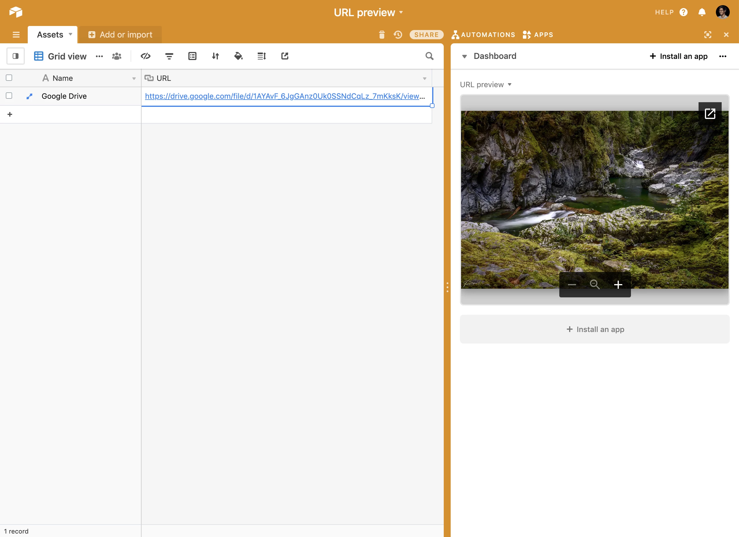

@Marty_McCoy It looks like the URL you’re trying to attach points to a web page, rather than a direct URL for the raw image. This means when you’re updating the record, you’re uploading HTML rather than the PNG/JPG/etc itself.
Have you considered using the URL preview app instead? This will allow you to preview Google Drive share URLs by clicking cells in grid view:
