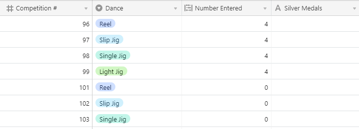

My database will be used to organize a dance competition. I’m trying to construct a formula to calculate how many medals I will need for each competition. The number of medals needed depends on the type of dance and the number of competitors, a few of which are shown in the image below:
My formula keeps returning an error (Sorry, there was a problem saving this field. Invalid formula. Please check your formula text.). I have been through many Airtable articles, tutorials, and forum posts, and still do not know what I have done wrong. Any help is much appreciated.
